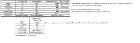

Platonic Solid
Nov 29, 2014
3,587
CT-USA

Platonic Solid
Nov 29, 2014
3,587
CT-USA
I sell these and people love them. I can get you to 75 lumens per sq foot for $1200. Message me if you are interested.
1. Anyone can buy these direct from the Chinese manufacturer Lonyung LED Lighting Co., for half the price you're selling them at and that includes shipping.
2. The product part number you show is not listed in the UL File. The actual part number for the 4ft is LY-T8DL1200-22W.
3. Intertek warns of counterfeit cETLus Certification mark on Lonyung LED Lighting Company LED lamps.
4. 5 year warranty. :lol_hitti Good luck with that.
jtpfarm
Mar 6, 2015
28
Anybody can buy anything from china. But not for half the price with shipping. Smaller quantities cost much more.
Anybody can buy the lights that you push directly from china too.
The company and part number are listed directly on ETLs website. As well as DLC.
Factory offers 3 year warranty, I take it to 5. Tell me again about the almighty FT32T8 warranty. And the ballast warranty.
My question is, why did you even respond to my post? It wasn't for you, it has nothing to do with you. Yet your intention is to run everyone down that talks about LED. I am a young person trying to start a small business to support a new family and all you can seem to do every time I post is try to shoot it down. You obviously are in the lighting business and anyone can buy the same things you sell from china too. You have nothing special over anyone else. Your grid above is full of lies. I have corrected it for you in the attachment.
I have no doubt you will reply to this with tons of mumbo jumbo about how I am wrong and further put me down but I don't care.
By the way, anyone can order T8 2 bulb fluorescent fixtures from china for less than half of the price you show.
Somehow before I made my previous post I knew that you would be the first reply.
