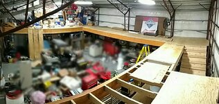

I've been eyeballing these to go under my mezzanine I'm almost done with. The linkable feature looks nice so I can stretch these above my head and I thought about wiring a wireless switch to them that I could mount to a post to turn on when needed. The shop was bright before but it's dark under the mezzanine. The lights would be about 7½ feet above me.
