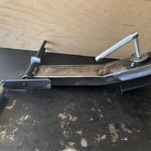

My neighbor drives truck, and he has to wind the 4” straps several times a day. A couple of years ago, he asked me to make him a better strap winder than the cheap one the company issued.
This was my original build. 1”x3”x3/16” channel, knurled aluminum handle with bearing, bearings on the winding shaft, and a knurled aluminum locking handle. Over the next several months, I made changes as it got used a lot and failure points became known. A brace was welded to the end to stiffen the clamping flange, a better handle was made, and joints on the winder and handle got welded instead of screwed. It has worked great for the past 18 months.

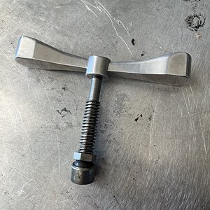

Yesterday he told me that the clamping thread was getting loose And he was feeling some give as he tightened it. Originally, I had used some grade 5 3/8-16 all thread for this piece, but it wasn’t holding up well. After some thought, I took a piece of 1/2” acme threaded rod, trimmed down the ends and threaded it for 3/8-16.
The handle and swivel end then fit without having to be remade.
I figured that the acme thread would be much more suitable for this job. I didn’t have an acme tap, so I turned a nut down to round, drilled out the existing hole to be a press fit for it, and pressed it in to the assembly.
Here is everything assembled. Note the reinforcement on the end and the pressed in bushing. Following is another shot of the finished assembly.
It has been rewarding to be able to use my shop to help out a good friend.
