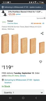

My Dominos came in today. Since I still have my dad’s biscuit jointer at my house I thought I would take some comparison between the biscuits and dominos.
It’s hard to photograph but here’s a side profile so you can see the thickness. The biscuits are just under 4 mm thick while these dominos are 5 mm and 8mm thick.
