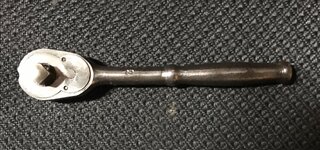

I received this 1/4” drive Snap-on ratchet yesterday that has me a little confused. It looks wartime but rather than an E or a G it has a 3 stamp. The three doesn’t at all resemble the 1943 date codes shown in the date charts. What do the Snap-on experts think?IMG_2366.jpegIMG_2393.jpeg
18granite
Apr 28, 2021
10
CA
That is the correct 1943 date code, they dont show up too often.

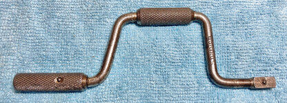

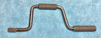

9/32 drive speeder, possibly the only one to pop up, this was pictured a few pages back in this thread. Has pinches around the center grip. Logo compare with a couple other early 9/32 pieces, and size compare with a 1/2 drive set in old custom case where I believe someone attempted to copy a master set case to save a few dollars.

Hmmm. I guess there are no absolutes, but on every SO date decoder chart I've see, the 1943 "3" has a distinct cupped curve to it's horizontal component. But, hey, there was a war on...
And the ‘43 marked tools are so rare that there are very few examples to compare to. That’s why I was so glad to see Lugz’ 1943 ratchet. Here is another newer tool with a 3 that doesn’t match the date code charts.IMG_2391.jpegIMG_8164.pngIMG_8163.pngIMG_8165.png

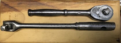

This weekend I got some 1/4 drive S-O clutch head sockets in a trade w/ member D42jeep.
Monday I made a little socket rack for them. It's not my best work. I might leave it or shellac it or make another if it really bothers me.
Not the same years but 50s. Goes great with my other set in my 1960 Snap-On tool box
