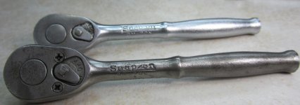

The top is a GM70N with a 38 code, front is a GM70L with a 42 code.
It is possible the 1/4 tools were made in 43, but the only proof is 44, so right now its best to say its 44 unless something comes up that says otherwise.
Have you ever noticed the offset in the screw position on some of the early and mid 40s 9/32 and 1/4 rats.

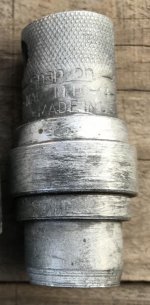

Picked a pair of 1/2-inch square drive sockets from the flea market this morning, a 9/16" 6-point from earliest known production (1920-1924), with the mid-wall band of knurling and the SO overstrike stamping, and a wartime SW-190 19/32" with a 1944 ("E") marking.

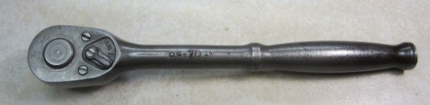

PF-70-N industrial rat. 37 code. No Snap on name.
