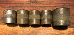

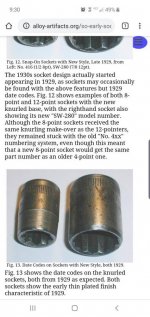

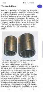

NJ is well-known for respecting strikes of all kinds, including overstrikes (see Pic 1). This early "Snap/on" logo socket (See Pics 2 & 3), made in 1929 and new old stock in 1931 and 1933 (See Pic 4), didn't fare so well however. Then again, it was the Great Depression, so the mechanics maybe only had one pipe wrench between them to turn it!

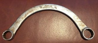

I'm curious if a Snap-On ******** can finger a date for me on this half-moon wrench.....I've been combing catalogs and haven't located the "VQ" in this part number. I know that the CX2024, as an available size, came on board late 30s I believe, but hoping to nail down this one, and wondering what the VQ is supposed to stand for. Thanks in advance!
