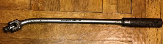

I own a 1/2 offset breaker bar that, because of the bend, somewhat resembles the No. 1 breaker bar Snap On manufactured in the 1920's. If it did not have the bend, my breaker bar would closely resemble the breaker bars Snap On manufactured during the 1940's. My breaker bar is 16" long. It is marked R-34 - Made in U.S.A. - ALLOY. Does anyone know who made it?
30,981
I suspect that is a hinge handle (colloquially, "breaker bar") that has been bent, redtop. I don't recognize it or the model number off the top of my head. That Snap-on Offset No. 1 handle is very late 20's. The earliest version had a straight shank and the drive stud was in a head that was fixed on the end of the shank at a 90* angle.
