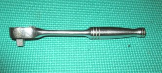

I need your help again. According to the collectingsnapon website, the newly designed 3/4 F71 40 tooth ratchet was manufactured in 1948. I cannot find an image of one online. Please post a pic of your 1948 F71 ratchet if you have one or if you can find a pic of one online.
Here are pics of a 3/4 1949 F71A I recently purchased. The seller indicates that it has 40 teeth. I wonder if it is as smooth as my Bonney T707 "sweetheart" ratchet. Currently, the Bonney T707 is my favorite vintage 3/4 ratchet. I have posted a pic of one that sold recently on ebay.

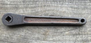

Here are a couple of wartime sockets with two date stamps and another rusty oldie. No plug on the old ratchet, unfortunately.
Thank you for posting additional pics of your multi-date code sockets, Don. I hope you find a plug to fit your No. 7.
There is a No. 7 currently for sale on ebay with two date codes: 1929 and 1930. Here is the link: https://www.ebay.com/itm/223927529973
