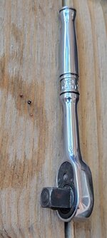

3/8 rats in a 1/4 frame. detent pins. Model KFM70 1966. and KM70 no date code. These are the only ones I have seen. The KM70 is 1/8" longer. has a diff. selector switch but the KFM switch has been replaced.

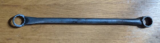

Just picked these up at a flea market for $8 total. Hard to find vintage cheap tools around here.
