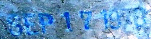

I was incorrect on the year...in looking at this (i just now unloaded it) it has a stamp of 1966 on the bottom. I do have a coupl 1/4 blocks that are 1959...really heavy and spin for over a minute after shut down.
So I dont have time to get to it today but I will take the tray off the bottom tomorrow and see if it says anything. Does your 69 look exactly like it??

Belt - I have these pictures of a model 397.19590, like yours.
I'm guessing the mfg date is 'SEP 17 1978'.

No way that is 78....more like 68....the 70s are much different. Thanks for the diagram!!
That's my thought, too. The stamp is very difficult to make out, and the cover may not be original.
