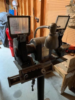

Before & after a mostly cosmetic makeover, intermittently documented upthread.DB0AD857-DE65-46FB-A507-CB98AF704AE3.jpeg
Beyond a total repaint, it needed a replacement gooseneck, which needed a new socket & wire. I used 16-14 AWG female connectors, instead of 22-18, because of an apparent nationwide shortage. One guy told me they were on the ship grounded in the Suez, which I thought was pretty funny. I will probably replace them (I left a little extra length) when I address the dry bearings. I have not been able to pull the cast aluminum housings off the shaft, no doubt due to corrosion. I’ll have to devise some way to get support inside, around the bearings.
It won’t get immediate heavy use anyway (I have three other grinders), but I wanted to get the pieces together before they got lost.

Nice job, but I would be leery of using that aluminum plugged wheel. I've never seen any issues from them, but this forum claims alot of accidents from them

LesserSon, nice job. I am jealous of the pedestal stand. I have been looking all over for one.

Thanks, and thanks for the reminder, exmaxima1.
If I dress it, wouldn’t that remove the hazard? Is it the physical expansion of the oxide, or a chemical reaction that damages wheels?
I’m pretty sure these are the original wheels. Since it was so obviously exposed to wet conditions (and for all I know freezing temperatures) I’ve had them off, and they rang well.
Edit - read two articles.
One just warned against aluminum melting and accumulating on the wheel (looks like mine). I can see that it could then fly off at speed if not removed.
The other warns against explosive combustion (4500°!) if aluminum and iron dust mingle and ignite from friction or sparks, and advocates dedicated wheels to single substances.
Neither suggests direct structural damage to the wheel itself, but I welcome any guidance.
I actually did use the finer wheel to reprofile a broken dining knife without incident, shortly after I bought it.

I'm no expert on the subject, Lesserson; but, I routinely replace the stones that come with the grinders I acquire.
Mostly because there's no way to know if the stones were exposed to moisture, which will degrade the binder in vitrified grinding stones.
New stones are available and affordable from Amazon, Graingers, ....
Nice job on the restore BTW.
