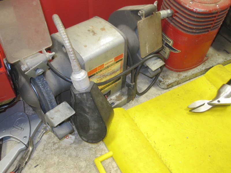

Here's a couple photos of my block grinders one is a Delco I hope it still counts :). And the craftsman vibrates pretty darn good so I'm waiting to make a stand and get good wheels.

That's the first Delco Block Grinder I've seen, cool!
Can you post some more pictures, including the label? I'd like to see the model #, etc ...

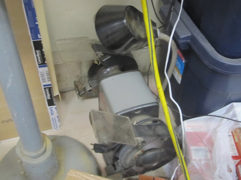

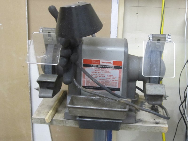

Here are the pictures you requested torqueman. I got the grinder from my grandfather who inherited it from my great uncle mike who was a big tinker. And it does run as good as it looks.
torqueman2002
Jun 3, 2009
6,139
SE Michigan
Man that is nice, and the color! Looks like original paint too. Is it?
Have you bee over to OWWM.com ? (Old Wood Working Machines) Their site has MFG info. with model numbers and mfg. dates.
IIR Delco was a supplier to Sears for the Block grinders, this sure looks like the spitting image of CM Block grinders.
There's a lot of family history there, makes it all the better. :)

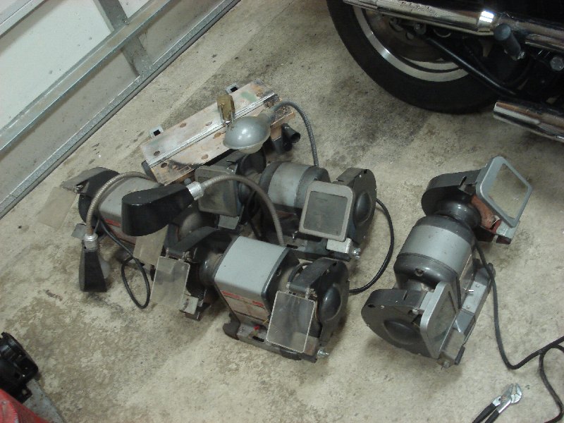

I have a few of those block grinders, they seem to multiply. Picked 3 keepers, the rest will hit craig's list.

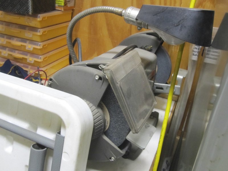

Becoming a Blockhead:
All the parts are there- model 397.19580 from 1964. It came out of an old gents attic, his grandson was selling it on CL. He had been a lathe operator at a local shipyard and made jewelry at home. I include the carpet that was on the bottom of the grinder- it shows its vintage. What made me drive across town in rush hour traffic though was the extras:
All manner of buffing and grinding wheels and compound. Lots of sanding disks and emory paper too.
The grinder never was fitted with the light. The hole was never punched out for it or the water tray. Has anyone retrofit a light to one of these?
Seeing the beautiful restorations of these makes me want to do the same, but since its running smooth I'll just put it to work.

Congratulations, nice grinder.
'Blockhead' !!??!! Well now, I resemble that remark. I even added a picture to my profile and signature just now. :thumbup:
To fit a lamp like the following one, connect the neutral (white/ribbed) wire of the lamp to the neutral (white/ribbed) wire inside the grinder, and the hot (black) wire to the hot (black) wire inside the grinder; alternately, connect the hot to the controlled side of the power switch. That will turn off the lamp with the power switch or you can turn it off at the lamp (the switches will be in series, both need to be on for the lamp to turn on)--> http://tinyurl.com/ka87ssb
