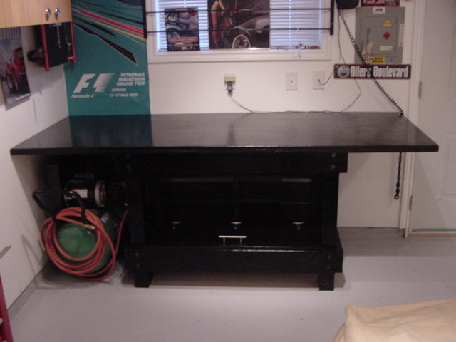

OCD
Dec 30, 2014
1,316
Edmonton, Ab. Canada
This is what I came up with for my first work bench build...
It doesn't look as good anymore, but has been really solid!! The height has worked out great too...
