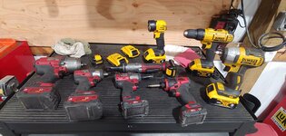

Finished making my own MCF902. Took the guts of a DCF902 and installed them into the MCF801 clamshell. The “precision drive” mode on the impact driver functions a bit differently than the “precision wrench” mode on the impact wrench, so I had to move the circuit board over as well. The covers for the mode switches on top were direct swaps as well. Tested and functions perfectly - I have no idea why MAC doesn’t release this tool… It’s my favorite impact wrench (even more so now in chemical-resistant MAC red and black) and covers 90% of what I need an impact wrench for.
As I assumed would be the case, the internals of the MAC/DeWalt 12V impact driver and impact wrench are identical.
The drive assemblies between the impact driver and impact wrench are also identical aside from the 1/4” hex collet and 3/8” square drive anvil. Impact driver on the left, impact wrench on the right:
Tested on a 21mm fastener:
Family pic: MCF601, MCF901, and the “MCF902“
