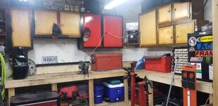

I had more than a whole year before I moved in and should've done the garage first. Instead I have temp work benches and few of my tools in place.
The chrome shelves and totes are the ones I just got from a closing dist center I found on CL. Shelves were $15ea and the totes were $3, Got 7 shelves and 30 totes total. Shelves and totes are 24" deep.
I swear I used to be organized. Go back and look at my old garage, damnit. LOL I know I'm not the only one with a mess.
I have a 12x8 shed my lawn **** and seldom used tools could go into once I move it. Not to mention all my attic storage space.
