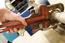

The opposed-wrench-squeeze trick.
(sorry, just my left hand as my right is holding the camera--should be both)
I have to break that union apart because I'm having a really bad, no good, truly awful evening.
If you use two wrenches opposed, as you would to break something like that apart, instead of showing off your awesome pecs, put the two handles a few inches apart and grip them with both hands, just squeezing the handles together. Its amazing how well this works. I swear I can get much more force than using two hands, one on each wrench--and when the fitting comes loose (or a wrench slips), your hands don't go anywhere--no busted knuckles.
Some old plumber I worked with at some time showed me this trick and I will owe him forever for doing so.
Oh, yeah--why it's a really bad, no good, truly awful evening:
That's the boiler for the brewery. The boiler provides the heat to boil the wort to make the beer. The firebox of the boiler is full of water, meaning we need a new boiler, as this type is not repairable. It really just gets worse from here on out.
