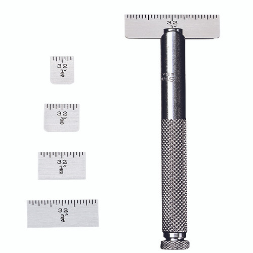

I bought several cheap flexible 6" scales and cut them into shorter pieces. Handy for measuring in tight spaces where a 6" scale won't fit. You can clamp them in an Xacto knife handle for more reach. Starrett makes a set, but $$$.
