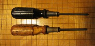

I had a buddy that liked wood handled screwdrivers and one day, while out junking, I bought a little tool box, along with a dozen or so old screwdrivers, to add to his collection (of a few). He was thrilled! I don't see him much anymore, but I kept on bringing them home, so now I have a collection. Many, if not most, are not marked with a brand name. I'm actually surprised when I see one that is. Pinning down a maker based on handle, or ferrule shape is tricky too.
I'm trying to be more selective about which ones I bring home these days. This little blonde handled one appealed to me, but I left it in the bin for two or three visits, before finally bringing it home yesterday.
It doesn't have a maker's mark, but sure goes nicely with this little Vlchek example.
Sorta like salt and pepper.

Does it have a Phillips License number? Is it LIC 6?
It says Phillips Lic. and then the ferrule covers a number, if there is one. It also has the two patent numbers, plus Made in USA.
The black handled one does not have the Lic. marking, but does have both patents, followed by Made in USA and ALLOY
Okay, I pulled the shank out enough to see the #6 on the blonde one.
edit-- what does the Lic. # tell us?
13,412
License says who made the shank.
From Lugz' informative thread here
LIC-1: Stanley, Blue-Point
LIC-2: IRWIN, Apex
LIC-3:
LIC-4:
LIC-5:
LIC-6: Vlchek
LIC-7: BHM
LIC-8: Bonney

A few days ago I found a large Phillips wood-handled screwdriver at my local Habitat store. I picked it up because I saw the "made in U.S.A." stamped on the ferrule. However, I have gone all the way through this thread and I cannot identify this screwdriver. The ferrule has me hung up. I don't recognize the shape, and it simply says "made in U.S.A.". The shaft has the logo marking of Reed and Prince, but that is all I have to identify it. The handle was covered with yellow and red paint, the yellow appearing to be much older. There are very light flutes in the handle as well. I am currently cleaning it up. The Danish oil is drying for the next few days, and then I will apply shellac.20221204_201846.jpg20221204_201938.jpg20221204_202140.jpg20221204_202213.jpg
I didn’t recognize the ferrule on your screwdriver either but I spotted this Phillips screwdriver on EBay this morning with the same ferrule. It’s a #3 Phillips and above the patent numbers it’s marked “Lic 1” leading me to think it’s likely Stanley.
-DonF7CC88D2-7971-4433-B7D5-72F18CA2CBE6.jpeg1E25CAC8-C7BB-4483-8FFD-BB5BE7202BA6.jpeg05ED36CA-CB74-4730-A450-BBFB52FE7804.jpeg
Yes, that ferrule and handle look just like mine! However, I looked through various old Stanley catalogs and their Phillips screwdrivers look completely different. I am starting to think that whoever manufactured the handle and ferrule contracted out to other companies for various shafts.
