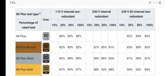

2500 watt @ 240 is close to 10 amp and 2500 watts @ 120 is about 20 amps. Most 120 volt circuits I have seen are max 15 amps and running that for extended period of time is probably not safe.
Items like mini instant on portable water heaters are normally 220-240 volts.
High end computers run 1500 watts.
Yogurt machine I have is 240 volts.
Not sure other stuff I have as many is 110-240 input voltage. But seems to me that lower amps/current result in lower temps in the wires. Which seems to me to result in lower risk of fire.
My old house had aluminum wires and not copper this resulted in me only able to use my computer which was 1500 watts in the winter or at night because the breaker box was heating up quite a bit. At first I had the breakers replaced , then the breaker box , then the whole house got rewired in copper wouldn't put 240 in my office not sure the exact reason. But running that PC on 240 in the garage and checking the temp of the breaker box vs 120 temps were about 50% less on 240 than 120.
At work I have some computers running on 214 volt lines not sure how or why but marked multiple times with 214.

no way does a high end computer run at 1500w.
I have an HP tower server gen 8 with dual xeon 6 core CPUs, 7 10K rpm drives and dual 750watt power supplies (DC wattage) and Eaton enterprise grade 5PX UPS with load monitoring and my server pulls 140w. This is corroborated with iLO power monitoring internal in the server that says the same thing. My dell tower pulls less than 100w.
your numbers are way off. way way off.
BTW 240v is NOT more efficient than 120v. You know why? because its the same wattage.
you proved this yourself with your 2500w example. When its the same wattage at 120v and 240v there is no efficiency gained.
BTW if youre breaker box is heating up from 1500w youve got issues with a bad breaker box NOT the 1500w load.
My 125a service sees way more than 1500w running through it (2 ACs, 2 electric stoves, 1 dryer, 1 water heater; all at the same time as my meter feeds a studio in the back) and my breaker panel does not heat up.
your example falls flat on its theory...

I build my own computers and have so for quite some time and when you dual socket CPU and two or more gpu's wattage can run quite high. Let alone 5+ 1000-1350 watt asic miners. Ant miner s9 type stuff wattage gets high. Let alone dedicated graphics work stations where some single images can take 12-24 hours to render. The miners ran off of dual 750 watt sever PSU or what ever I could find. Total wattage was from the wall was around 4000 watts.
My dual Xeon ran dual 980ti gpus that was liquid cooled the 1500 watt psu was older style which was really two 750 watts connected together. 260 watts for the CPUs plus 500 watts for the GPU. Already maxes out a 750 watt PSU. Problem here is current on 12 v rails.
A 1500 Watt silver stone for example has 7 12 volt rails at 25 amps max. This totals out to be 2100 watts alone. Not all 7 will run at full current. A 1500 watt power supply is generally 800-900 watts at the wall. But multiple high current rails are needed.
Hard disks run at very little current compared to CPU under 24/7 100% loads 1366
X5675 running at 4.2 GHz @ full load for 24/7 is not energy efficient at all compared to modern rigs.
Your 750 watt power supply probably rarely sees over 400-500 watt at the wall. Mine was consistently @ 825 watts at the wall. T
At the time I was running this stuff it was said that bit coin mining was something around 66 Twh currently 76 Twh which is more than the entire country of Israel.
Also not sure if hp made anything "high end" in the last 25 years.
Probably efficiency is the wrong term but with my units the are gold or platinum rated for efficiency.
When used on 240 outlets the efficacy in terms of wattage from wall ac to DC seems to increase less loss of power. Not in terms of efficiency when it comes to bills or anything 800 watts from wall is still the same but the 800 watts from wall to PC with less loss is what I meant.
Yes I had all the power and breaker boxes replaced at that house.

Efficiency is not always about bills. Many ac/DC power supply Less amps, less resistance, less heat, less worries.
A 1000 watt gold rated power supply may for example draw 6.5 amps on 120 rather than 6.0 using 240. But it's been years since I ran tests like that never tested on platinum rated PSU. In an PSU the main bridge rectifier and the PFC boost converter are where the gains on 240 volts are every other component runs the same on 120 or 240 volts. In ac to DC capacitors will be charged to 240 volts when using a 240 volt outlet. And this will improve rectification.
Titanium rated power supply is 94% efficient on 120 volts and 96% efficient on 240 volts.
I know little about the fine details of this but in ac to DC 240 is more efficient. I will stop talking and post an chart from energy Star.
That efficiency does nothing for you though. Tthe net result is the same because the wattage draw is the same. Less conductor heating does not lower the electric bill. So it is not more efficient on the electric bill.

as mentioned above some power supplies are more efficient with higher input voltage.
higher wattage ratings on 200v class power are often because of the amperage limits of 120V circuits.
