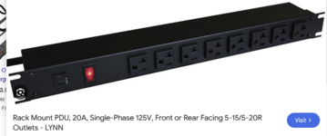

For instance most residential power strips are 14gauge 15amp. I get that it makes sense to down step everything downstream of the 20amp receptacle but a few tools are right at 15amp draw. So don't want to be popping that breaker on the strip.
You need 12GA 20A. They're a little hard to find.
Might search for "20A PDU" - you can find these used and not pay a fortune for them.

Not sure if they are worth it for you, you can use with 15a plug adapter... I got a few APC AP7801 units from eBay for cheap. They were new but you can get used as well. They show total Amps in use and you can even go so far as to network them and they might have some port control functionality.
