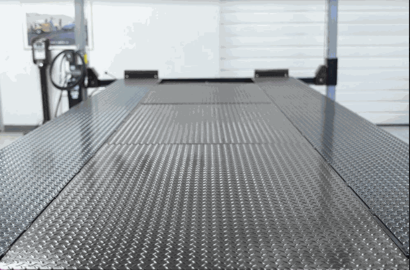

Something I didn't see here (unless I missed it) was alternative uses for a 4-post for work space. Anyone with a small shop/garage repurpose a 4-post lift for a liftable work and/or storage space with a work bench? I have been thinking about something like this until I get a new shop built. Would be a little clunky to step UP to, but if you're desperate for space, it could serve as a great flexible option.
I know for my lift, Advantage sells a solid Deck mod for multiple options, boats, ATV, Mowers, storage space.
Jeez!
At that price, I would think I could either make my own, or have a local shop create one for less.
