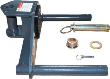

Not really a mod but got some new accessories for my amgo lift, wheel support adapters and adj lifting pads IMG_3748.jpeg IMG_3747.jpeg
Let us know how well they work when you get a chance to try them out. Do you have a symmetrical or asymmetrical lift?

Not really a mod but got some new accessories for my amgo lift, wheel support adapters and adj lifting pads IMG_3747.jpeg
Those are really reasonable in price. What is the diameter of that pin? I think any of us who want a set would be thinking about the fit. I would need to make some mods to get that to work on mine.
