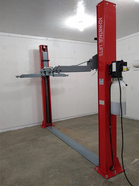

I have 10'6" celing height and I am 6'3" tall and can stand straight up under my C2 Corvette. I installed a Jackshaft opener which gained me an additional 1' foot of lift height. Liftmaster 8500W and my lift is an Advantage DX-9000HD 4 post lift which I think is the best lift on the market with all you get for the money! Contact Tony Weber at Advantage Lifts, he's a great guy and customer service is second to none!

I haven't made a final decision yet, but I'm leaning towards the Advantage Lift. I'm still waiting on approval/permits from the city, so I have some time to think about it.
