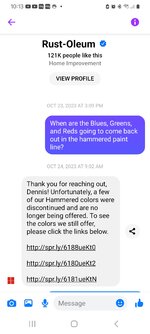

I emailed Rustoleum yesterday about there Light Blue Hammered spray paint. This was a follow up from a email I sent them last fall. Last fall they said it should be available after the first of this year. Yesterday they said they had no stock and were not sure of availability. Told me to check back in a month or so. They didn't seem to care that I had a Craftsman tool chest waiting to be finished. Lol

deezil
Oct 25, 2023
45
I got this from them last Oct.
