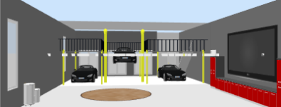

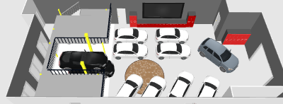

Looking for some expert advice. I am adding on to my garage and working on the lighting of the bays. Ceiling height 9'.
Based on input from GJ, I had my architect draw in 16' fixtures on either side of the vehicles and a 4' at each end (see attached). My goal is to have a show garage for sports cars. I like the CREE fixtures because they look sharp and are dimmable, but they are pricy. I like the dimmable aspect because I don't want this to feel like a tanning booth and I use Lutron lighting controls.
Any thoughts on my design?
Any other fixtures a good solution?
I opened your file because my garage is also somewhat like a showroom. Personally 16' fixtures don't look very "showroom". Unless your going for an industrial look. CREE is a brand so without a specific model its impossible for anyone to comment. If you decide to post again, post images and be precise. There is a ton of knowledge and experience on this site. Most are eager to help. Good luck on your build.

Redoing on of my garages. 70' x 36' x 15'. The ceiling will be painted black with the walls painted a dark gray/orange is what I am leaning towards. There will be a 20' mezzaine in the back of the garage. I am very concerened about lighting with the dark surfaces. There are currently only 2 circuits handling the overhead lighting. 10x6' shop lights. A good amount of light with white walls but wont be nearly enough with dark walls. Would prefer linear lighting. No hex lights. Looking for recomendations on fixtures and quantity. Would also like to install a giant ceiling fan in the front half of the garage so need to take that into account with light layout. TIA
