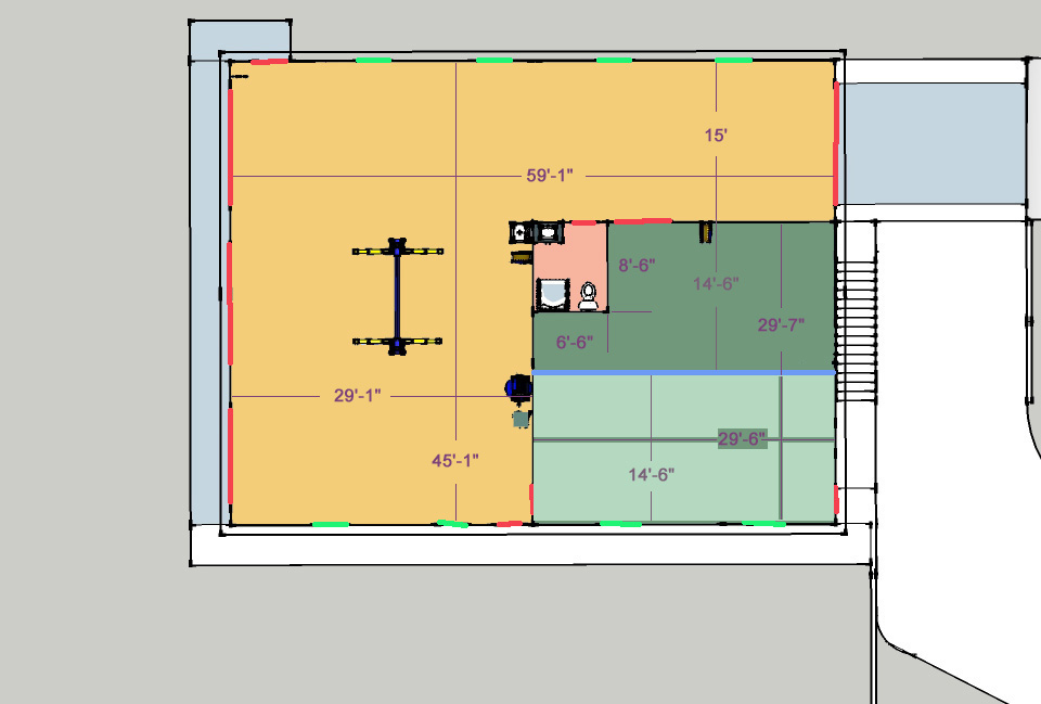

sbosecker 45x59x16 Garage w/30x30x11+16 ceiling Wood Shop
Original Thread
Flat drywall ceilings. All Ceilings/Walls painted white.
2 Post lift in center bay. Fan locations TBD.
Workbench locations TBD.
North side of Wood Shop Dark Olive area = 11 feet tall ceiling.
South side of the Wood Shop Light Green area = 16 foot tall ceiling.
P
Platonic Solid
Nov 29, 2014
3,587
CT-USA
Cooper Metalux
8TSSF-232-UNV-EB81 Qty.: 11 (or equivalent)
plus
SSF-232-UNV-EB81 Qty. 7 (or equivalent)
or
SSF-232-UNV-EB81 Qty.29
Lamps: Sylvania 22026 or 21767 Fluorescent T8 Fo32/850/Xp/Eco3 or Fo32/841/Xp/Eco3 (5000K or 4100K respectively) Qty.: 58 Lamps
