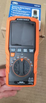

Would a multimeter like this one be sufficient?
Seems like things really jump in price from Cat III to Cat IV. Just want to be sure I'm chasing the correct tool -
https://www.grainger.com/product/80...MI-oD25MCskwMVcyZECB1gdBfSEAQYAiABEgKMnPD_BwE
I see many Cat III say good to 1000V, but the Cat IV up to 600V. Not sure how to interpret that, because I'm not an electrician - but with all the comments about watching where I put my hands, I want to make sure I'm doing this right!

So I have this multimeter now. It's rated for Cat III, 600V.
If I wire up one of my letters and plug it in, I can use this to chase down stray voltage, is that correct? Instead of finding it with my body?!
I'm trying to learn this as quickly as I can. Also trying to be safe.
