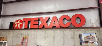

Red lamps help avoid hot spots white light could give, so if you retrofit to LED, get red ones. LED tape and strips are used at work. I do not do the engineering on them but the strips and tape require power supplies. The tape can be cut to length (at a designated cut line) and joined for extra length as needed. There are also channels with covers that help mounting and the covers act as diffusers to even out the light. If you do go LED, contact me if you need product information. I will see what I can find out.

I am a 40 year sign veteran, glass blower. Clear glass will be either red or light blue, since it had red faces the neon unit will be red. you match the illumination color to the face. when replacing with led if you go white the face will look pink. With a 4000v transformer you can touch any where on that sign and it will not kill you. When servicing neon you touch the glass when it is on and a working unit will feel peach fuzz on the glass a dead unit will not have the peach fuzz

The transformer says it is 130 VA at 120V. That works to about 1.1 amps per letter. Assuming they are all the same, that you should be able to easily run all of them on one circuit.

As an alternate, you can back light the letters by simply mounting LED tape on the back of them. You could do this pretty cheaply and even have color-changing capability.

So I have a set of large TEXACO letters that I've had for years; for as long as I've owned them, I have wanted to bring them back to some sort of funtional form - but I've never pulled the trigger...but now I think it's time!
I'm wondering how you experts would go about bringing light to these letters? Strip LEDs on the inside? Small directional LED spotlights that just point at the letters from the outside?
The original fluorescent tubes are all inside and in place, but I can't imagine that rewiring the original transformers/ballasts would be efficient/quick & easy, or affordable. The bulbs are likely near-impossible to find as well.
I'd love your input on how to do this. I have a little experience with strip LEDs, but not with separate letters like this; that might take 5 different power sources, wouldn't it (one for the T, one for the E, one for the XA, one for the C, and one for the O)?
Teach me your ways!
Here's a pic of the letters - right where they've been living for years and years. Time to do something with them -

Yeah don’t overcomplicate it, you don’t need 5 power supplies lol. Best move is strip LEDs inside each letter, that’s how modern channel letters are done anyway. Run all letters off one 12V or 24V driver, just parallel the wiring between letters, super standard. Skip the old fluorescents, total pain and inefficient. Use high density strips, stick them around the inner perimeter and maybe a couple runs across big letters like X and A so you don’t get dark spots. External spotlights will look cheap and uneven, inside lighting gives that clean glow you actually want.

Remember the signs were BRIGHT to attract your attention while driving down the road!! Add a stormy dark night, and yeah. To me part of the charm of these old lights was that neon intensity and the "buzz"... If I wasn't going to run the original lamps, I would leave the original neon intact, and use LED tape in the inner housing to power it to a lesser intensity brightness.
BTW - the other 2 gray boxes are neon transformers for stand alone signs ("FREE AIR" or "OPEN" or the like) - the tubes wire into the terminals on the end. And yeah, be careful, they bite. I check for transient voltage by brushing the back of my fingers across the metal housing - I've never heard it called peach fuzz until a couple minutes ago, but that describes it perfectly.
Good friend and coworker and his brother used to build Neon signs in his garage (THERE'S a rabbit hole to fall down!!) and made decent money,... fun to watch them at work. You can also use them to make a screen and glass plate ozone generator (a chapter out of my dark and dusty deep past life) to remove odors from the air... :pimpflash
BTW - while they're generally referred to as 'neon lights' the color they put out depends on the gas inside - Neon is red, Argon is blue, etc.

If those signs had fluorescent bulbs in them, I would say whatever, get rid of the tubes and replace them with LEDs.
But the custom bent neon tubes are just way too cool. Neon is a dying art, and there are only a handful of shops around still doing real custom bent neon tubes like that. Pretty much all of the cool-factor (and collector monetary value, too, if that matters) relies on those hand-made neon shapes being in that sign, IMO.
You tested the sign with the lights in the shop off. These signs were meant to be lit up at night. It doesn't take very much light to seem "bright" in the middle of the night. I suspect if you try the letters all lit up in the day with the lights on, it really won't be all that bright.
If you really want to go LED, just get some LED tape and leave all of the neon intact.

The tingle is entirely normal, especially in the tube. As long as it doesn’t cross into shocking you good to go.
LED and neon can coexist. In some cases the electric field from the neon is strong enough to induce current in the LEDs and makes them glow. Not an issue just weird and can mess with you aesthetic. That is a function of current, frequency, and geometry. Might happen might not.
