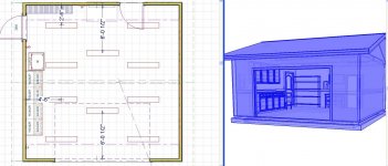

Actually, I was basing it mostly on your comment that "10 4' T8's would seem to be the right 'number'"; hence 20 tubes in 400 ft.^2.
Correct assumption(s), and the door was made smaller for that purpose. It also has high tracks (tracks at 8'2"). It also has a light panel (when open, light panel is ~6' from wall).
In which case, you MIGHT want to take advantage of that panel when laying out your lights, by placing your one or two "in-fill" fixtures DIRECTLY over that panel. It still won't be as effective as with no door in the way at all; but it's better than nothing. [Edit: OK, I see further down that you already did this. Good.]

I think the only way to adequately address this is via the switching scheme, so that if/when you're just "hanging out" watching TV or whatever, an entirely different set of lights is on (possibly just those centered walk-through lights) vs. when you're really working in there.
I was under the impression that tube radiate primarily perpendicular.
To their axis, yes.
So to eliminate shadows, you want them perpendicular to the work surface rather than parallel to it when they are not directly over the surface (if directly over, shadows are less likely).
I guess that depends on what you're calling the work surface. But the tubes are never "end on" to the floor no matter what their orientation on the ceiling; so this part strikes me as a moot point.
HOWEVER... Consider that (cylindrical) radiation pattern vis-a-vis your walls. If you run the tubes parallel to (and a few feet away from) the walls, you effectively bathe those walls in light, from ceiling to floor, and do so more-or-less evenly throughout the length of the tube. Further, with the fixture(s) presumably on the ceiling, that "wash" continues down and across the floor toward the center of the space, hitting everything in its path (most notably including the vehicle you're working on -- particularly the sides of said vehicle, where you're most likely to be working) along the way.
columns running up/down the diagram, rows running left/right (staggered being not precisely in line).
OK then, using that terminology, you want the bulk of your general lighting to consist of a "column" on each side of the overhead door, extending back far enough to cover (at least almost) the full length of any parked vehicle, plus a "row" running a few feet off the back wall. I don't see any real need to "stagger" any of it.

Sounds like my option 3 ... with orientation TBD.
Not really. Go back and read that paragraph again, keeping in mind what I just said about "columns" and "rows". In short: I'm basically talking about a big "U" shape, in plan view.

Attached is an option 2 showing benches/shelves for left and top (just placeholders with stock items). The right hand wall will have toolboxes, mobile tools, and a mobile welding bench.
This is also my "staggered rows" that is positioned so one lamp can shine through the door light when it's open.
Leave that one fixture where it is. Maybe even leave it's "mirror image" fixture to the rear where it is. But at least six of the other eight need to move (and turn 90 degrees).
If the 4 left and 4 right should be "columns" that's not a big deal.
More likely the front three, rather than all four. But then, I'd probably also endeavor to make each of those side "columns" AND the rear "row" at least four fixtures long anyway.
spoke too soon, the distance between the center beam and the slanted ceiling portion is < 8' (slanted portion is 4:12 pitch).
[edit]attached a **** rendering[/edit]
Ahhh... I see your problem.
Well then, it's time to make a decision: You can EITHER:
A. - Hang the lights somewhat below ceiling height, so that they can extend into those "sloped" areas, OR...
B. - Stick with surface-mounted fixtures; but make each half of each "column" (i.e., on either side of the beam) from one four-foot fixture and one "matching" two-foot fixture -- or, for that matter, three two-foot fixtures (which would give you still more switching flexibility). Here are some potentially appropriate fixtures:

I would near-certainly go with "Plan B", particularly considering your already limited ceiling height.
