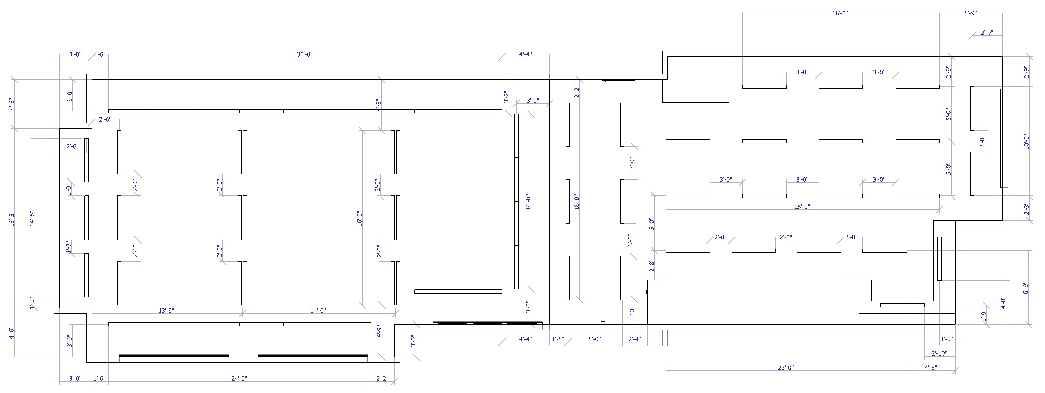

too hard to tell what is going on with all those lines, arrows and numbers.

I will see if I can clean the drawings up a bit.

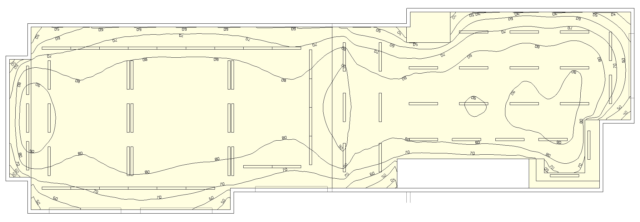

Ok Here is an Updated Lighting Plan.
I'll continue to work on it over the next few nights to refine it.
I revised it from the last one. Basically took two of Platonic Solids' designs and combined them. (Thanks Plato)
I'll build a circuit group diagram tomorrow to show which lights are on which circuits. (I like the ability to turn on control "banks" of lights at a time" for visibility and for task lighting)

The best way for me to tell you if this works, or to make a recommendation, is to model it in Dialux. I'm not going to spend time redrawing your floor plan. If you can provide a CAD file, preferably DWG or DXF, I'll give it a shot.

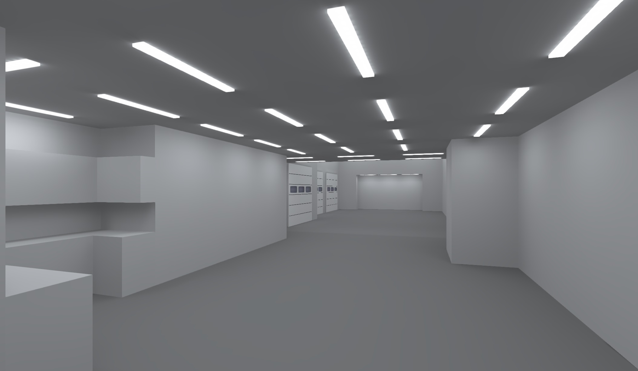

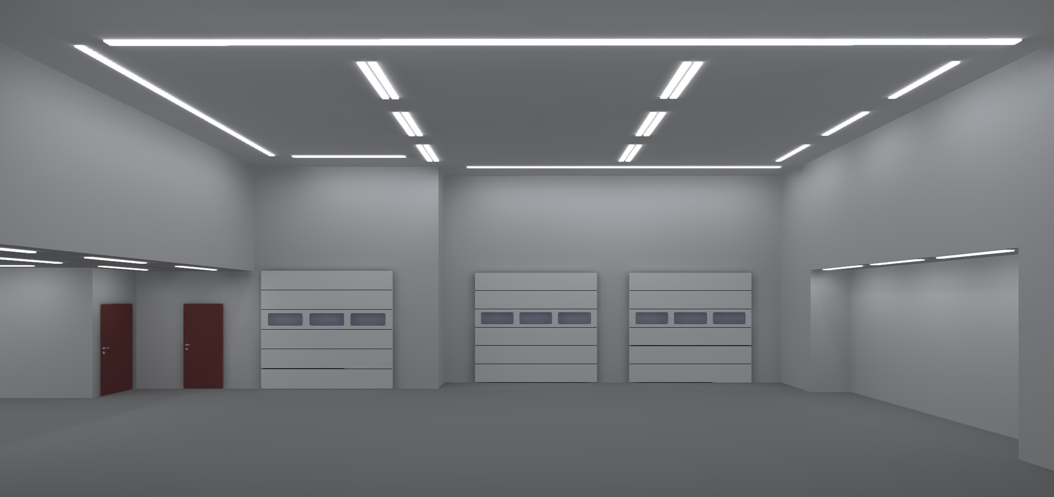

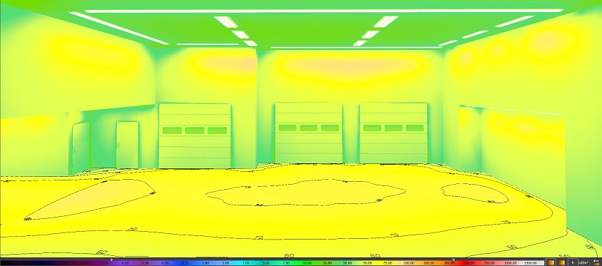

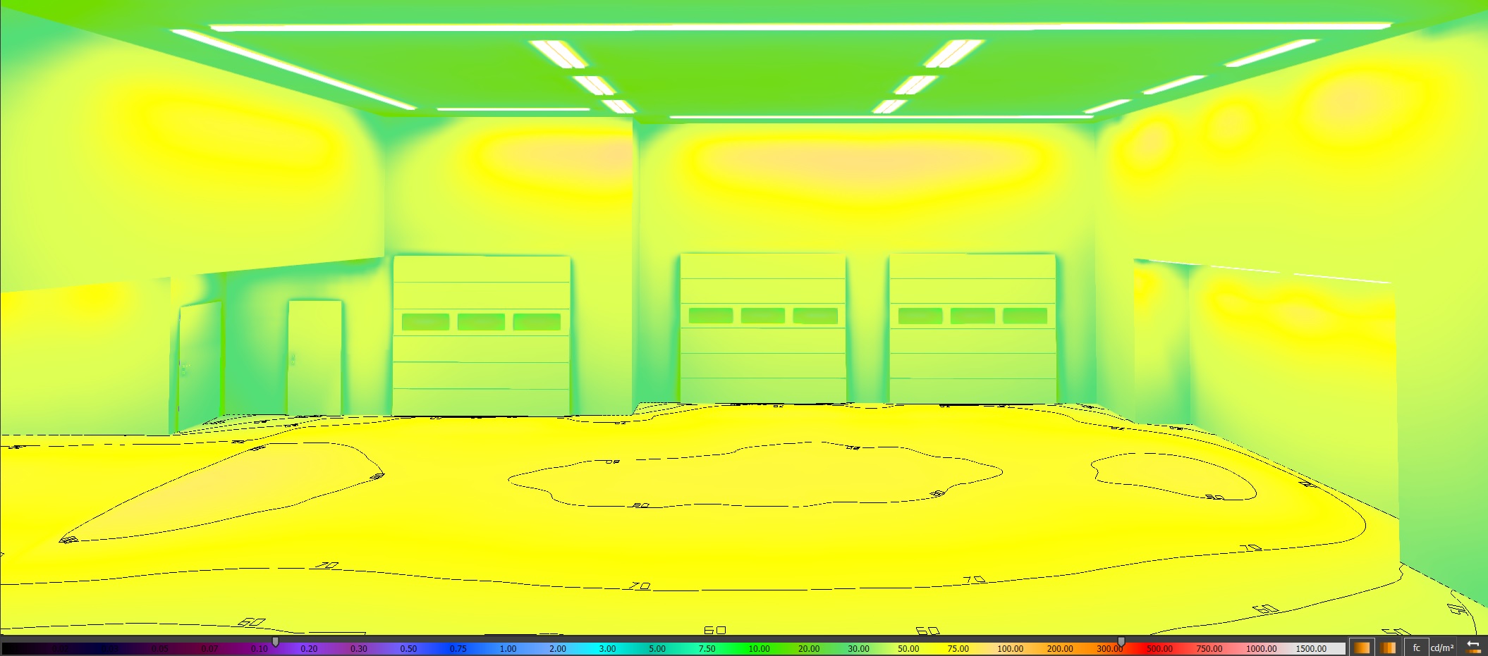

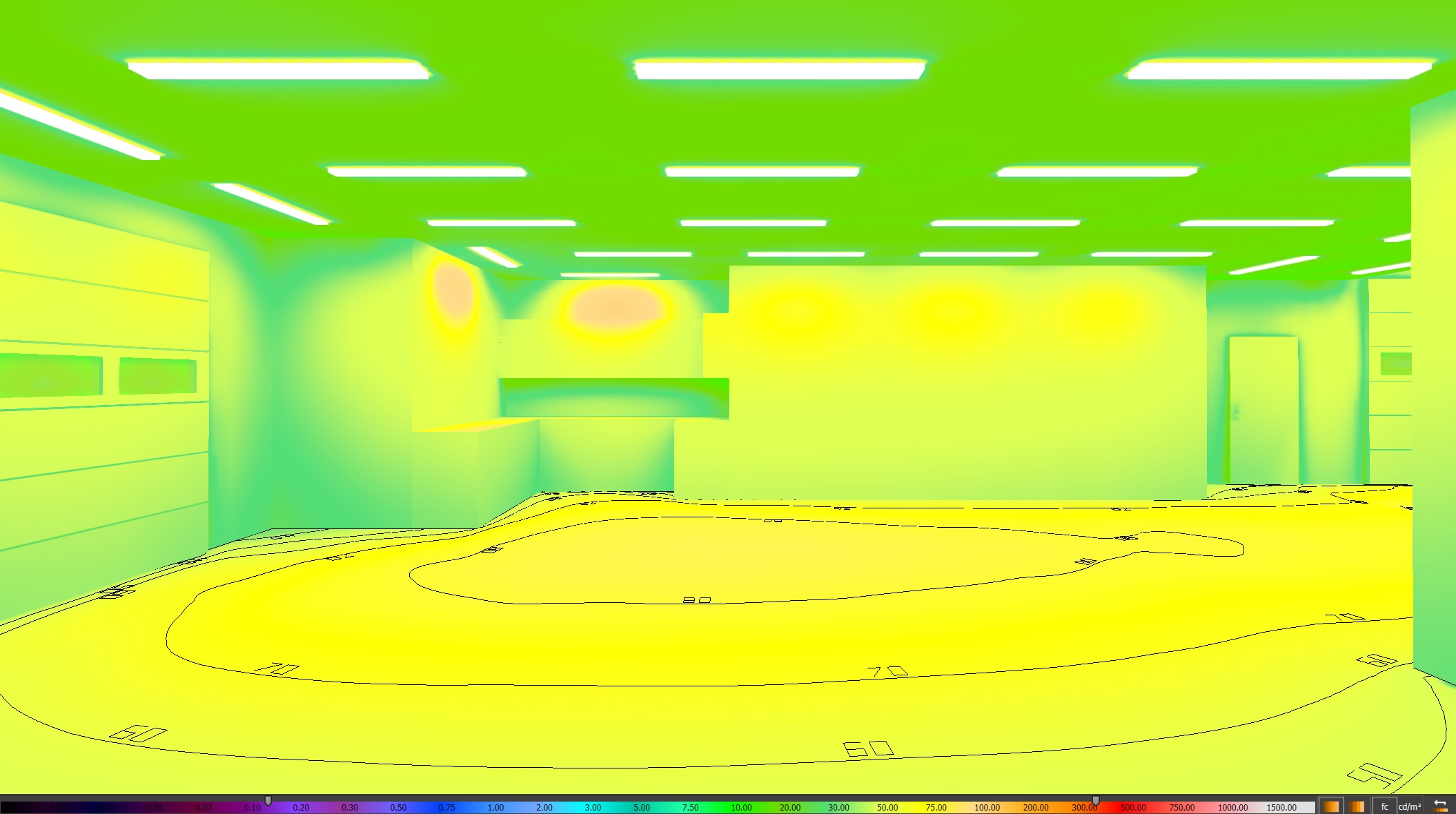

This is the best I can do with using the James 2-lamp strip light fixture. Had to double them up on the 17' ceiling to get the required output.
Dialux PDF here (linked)
All below images linked to larger views.

I can see I am still eating dirt here. It doesn't need to all be in the top of the ceiling, every time you drop a fixture down it makes more light. Light at floor is different than light at bench height. Dropping a fixture 3 ft in a 15 ft ceiling doesn't make a great difference with meter at the floor but move it up to a 36 inch bench and its a lot brighter.
I have a couple cfl, 13 watts hanging from a cord in the ceiling and can pass thru to local light to some extent.
Platonic Solid
Nov 29, 2014
3,587
CT-USA
sberry - You are correct. However, as this is a new construction, I assume the OP wants full use of the space that he's paid for. My layout is just a suggestion based on his original plan. The top isoplot image shows fc at 30" workplane.

Plato thank you kindly! I do have one question. Looking into the garage with your back to the three overhead doors there is a bump out on the left. That bump out has a 9 foot ceiling. Knowing that should I just add 3 more lights into the bump out at the 9 foot height?
Platonic Solid
Nov 29, 2014
3,587
CT-USA
Oh - I modeled that area as 17ft. Please stand by.
Previous layout images updated accordingly. Be sure to refresh your browser if you don't see it.
