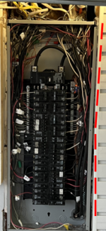

So I had my whole Panel replaced. Cleaned up quite a bit and hopefully this just installed panel will last another at least another 20 years. The one that was replaced was from 1984. House built in 1963.
Work was completed by a licensed and insured electrician and so far all is well and I have an accurately labeled panel. IMG_2218.jpeg

Did he forget his card that day? WTF!!!
Is there a green bonding screw in the panel anywhere (installed that is)?
Got any more pics?

horrible work but im curious what comes after the meter. is there a disco or just straight into this panel? if theres a disco then it should be 4-wire and there is only 3.
too bad the OP hasnt come back in almost a month
I came back as soon as the work was completed.
There is a green screw at the top, I do remember seeing it during the install.
There are several red circles but I do not know what the issue they are showing is as I am not educated on electric at all.

Can you take a pic of your meter and any discos upstream of the panel pictured

It doesn't get any better looking at it a day later.....
Did he drill out the upper right hole in the cover to make the screw fit when attaching cover?
What is the catalog number from the label inside the cover?
The problems in your electrical panel are mechanical in nature. Bent metal, missing screws, crooked fittings, missing parts on fittings, wires bent at extreme angles and poor attention to detail.
My point is take a good hard look at what is in front of you.
