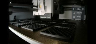

Gridfinity bins???
Yep. Slow as hell gridfinity bins. Each is ~57 minutes which means just one of my drill bit drawers is a week of printing. It’s frickin neat but it’s slow. I’m tempted to buy a couple more but my spidey sense tells me that’s what they want me to do…
It’s the age of the machine…

Print once, cry once?
I think you'll like those bins. But they do take forever, so I've got a lot of drawers left to print (as do you). Your cabinets are looking good!
Yeah, I think the customization and extreme organization of them make it worth it. That said, I’ll need half a dozen printers to get done by summer. I can read my wife’s mind - hell no. Maybe it’s a “it takes time” or “Rome wasn’t built in a day” thing.
Now I need to find the labels that’ll
Work with these things. Need them to have really good 3m super double side tape…
Thanks.

You can bump the speed up to Sport, 125%, and still get a nice looking finish. Ludicrous, 166%, is pushing it! The limiting factor is the volume of plastic that can extruded with the Bambu hotend.
If you’re really interested in speeding things up, do a little research on aftermarket hotends. From what I’ve read, you can increase the flow by up to 40% with better hardware. This guy discusses speed v strength v quality.

So it has begun, a 3D Printer…
Nice!
What size nozzle are you using? If you're on a 0.4mm you could jump up to a 0.6mm to speed things up.
No idea what you're putting in them but you could also try to optimize infill percentage, number of walls, and top/bottom layers based on how strong and durable you think the bins will need to be. If they are more light duty, I'd probably be doing ~5-8% gyroid infill, 2-3 walls, and 3 top/bottom layers. Idk, play around with settings in the slicer and see how it changes the print time and filament usage. Might be worth it to do some tests or optimization if you have a million to print!

For labels....I'm labeling all mine with a standard label maker using 1/2" label tape and it's worked pretty well.
I've seen some online where they made 3d printed labels with color changes in the slicer, but I never went that far.
As for printing speed...agree with @nicholam77, if you're not using a .6 nozzle and have it, make the swap, otherwise get it on order. I print most of my bins with 2 walls but it generally ends up being "solid" wall once it goes vertical. I'm using the bin generator at https://gridfinity.perplexinglabs.com/ and have turned off the magnets in the bottom and most of the other features that weren't relevant to me to improve print time as well

I understand that you can use a .6mm nozzle, up the line width to .65mm and keep the height at .2mm to maintain a nice finish. This way you can print a 2mm wall in 3 passes instead of 4.
For functional items like bins, I start with layer height at .30 to .40 on a .6 nozzle. You're cutting your layer qty in half and for me it still delivers a great finish.

You are on point! I don't want to derail this fantastic thread beyond this post.
I ran a volumetric test print to find my hot end's limit, it's about 18mm3 for a stock Bambu nozzle. The stock setting is 12!
Swapped in a .6mm nozzle and printing a part to compare. The slicer tells me it's going to save 2 hours on a 9 hour print! Im sure I could knock more time off but. I'd rather have a successful print!
