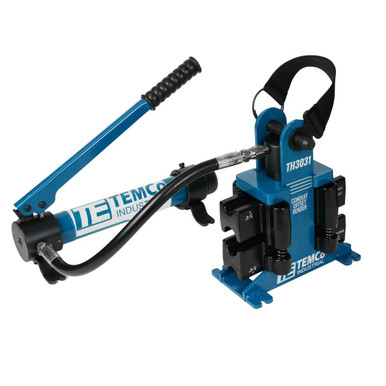

Also fabricated all of the conduit drops for the outlets…well half of them. Picked up this nifty tool for bending the offsets after learning how challenging it is to nail back to back subtle bends.
The tool uses two does that can do 3/4” one way, flip and 1” the other
First one is gravy, less than half a dozen pumps.
Flip it end for end and then use a level across the double bend to make sure the bends are co-planar to the machine
This little magnetic level has turned out to be quite awesome for conduit bending.
And then pump away. Finish is pristine and effortless. Pretty good for a $200 machine.
I recommend!

Box offset benders are definitely worth the expense. I picked up used Greenlee 1/2 and 3/4 benders on Craigslist years ago for $50 or so each. Next up you’ll have a wire cart. I bought one of these used (Greenlee) on Craigslist as well. That Temco looks slick.
Looking good!
Looking good!
