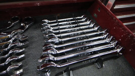

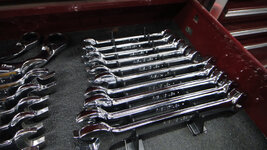

Hands down the best that you can buy today is the Snap On ones!
With your budget being open ended, I would buy the combination ones with the open ends, see what I did there?

I'll second what LXCam is saying. Anything less spreads and/or is not a precise fit and rounds seized flare nuts.
What you did there was hilarious.
Can't say I've ever seen this design before, but it sure looks convenient.
I used to have no complaints about my SK set, but now I wish they were like the above SO's. That is also 2x the wrenches (and the room) though. Only negative I can think of if you want to call "more tools" an issue. :bounce:
