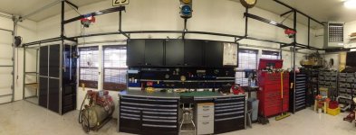

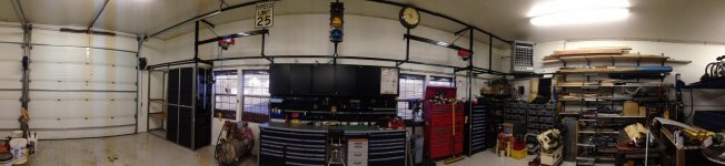

Strutting My Stuff
Some Pun there. Finally getting things organized and set in place.
Hose Reels
Got the air hose reel and the pressure washer hose reel relocated to their new locations. The air reel had to be raised up to clear the upcoming doors for the cabinet and I wanted the pressure washer reel to be reached from either bay so it was attached to the removable door section with quick connects if needed. I just need to run some more 1/2" .049 stainless tubing to reach the pressure washer reel.
Peg Board
Got the PVC peg board painted and installed on the side of the cabinet. Perfect location for the longer items to rest and the Dewalt table saw stand just happens to fit perfectly on the strut support I had in place earlier. I cut to size and slide a section of 1/8" sheet of black HDPE to enclose the cabinet side and aids in support for the peg board.
Things to move
The Husky tool box is empty and just waiting for my son to get his garage ready to take ownership of it.
The stainless fuel tank is on wheels and will be moved to the other side of the shop.
The rolling storage racks will be emptied when I am able to get some more Lista cabinets.
I found two Lista three drawer cabinets on Craigslist for $75 and put casters on them. One is in the main garage and the one under the bench will be used to transport tools to the lift when needed and painted black of course.

Yes, its great to see the entire wall in one shot like that akdiesel. Nice clock up there - what's the story on it? The pegboard looks good in that gloss black and really finishes off the cabinet end nicely. So what's next, the other half of that big cabinet?
And glad to hear your son is getting his own garage set up. What a nice young man he is. How far does he live from you?
A
akdiesel
Aug 8, 2008
2,617
Wasilla, AK
shopnut
The clock is a 1940's Western Union Navel Clock. I found it at one of the local picker shops and had to get it because of my eye sight being bad (19" diameter) and the history behind these. I still need to work on getting it to power up.
Need to gather some more metal to make the drawers and doors.
Then I will work on the far side where the Vidmar cabinet is and replace with a 56" wide x 59" tall Lista cabinet and make another roll out tray cabinet on top of that to reach the 94" mark. And that shelf in the right corner will be for an 80 gal. air compressor.
I will also add some more peg board on the side for crow bars and such.
