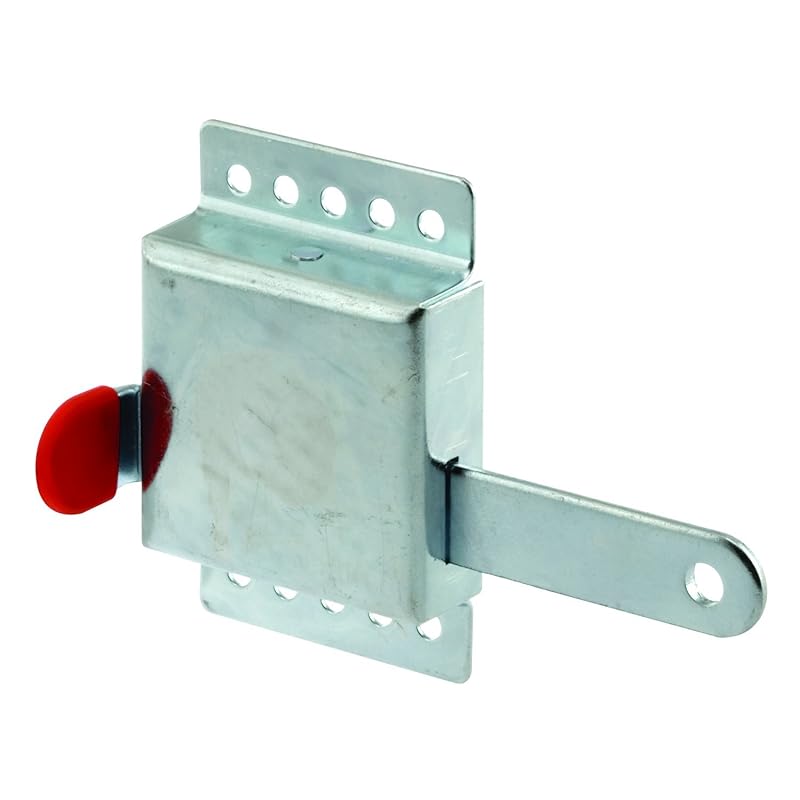

I'm thinking of getting one of these for each garage door to use when we are out of town for a few days. Might be the easiest solution, since I don't want to have to get a ladder to unplug the opener and it isn't on a dedicated circuit.
Anyone have a reason this would be a bad idea? Im hoping the opener would just bounce of the lock and stop. But I wouldn't want to keep trying to open for days...

The LM8500 comes with an automatic lock that throws a bolt into the track. Thus making it difficult to roll the door up. When going on vacation, just disengage the motor and keep the lock in place. Heck, you could even throw some vice grips on the other track.
https://smile.amazon.com/Prime-Line-Products-GD-52118-Galvanized/
My LM is plugged into a surge protector. But maybe just get one of the remotes inline that shut off the power for you, making sure it can handle 1500W or so, switch off with remote, verify off, vacation, then when return keep in car and switch back on, the LM comes back online after about a minute
