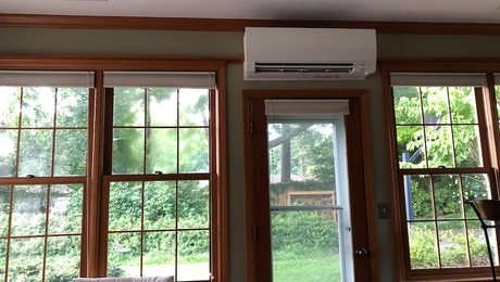

I'm curious what or where you saw this. I have experienced too big cooling with a traditional, 25 years ago equipment and the short cycling a lack of humidity control.
I questioned the guy that came out to quote me about this worry and iirc he said that it's not nearly the worry of a traditional set up.
My 5 or 6 years with it seems to back him up. When we give up on our preferred open windows and outside air and turn on the ac it runs hard until it satisfies the t-stat and then "putts along" seemingly barely running and I've checked, there is condensate dripping from both outside lines and the house is on target.
Maybe he just sized it right and we definitely don't have the same cooling needs (maine/ fl).
Most of my comment on hiring it out is proper sizing is "on them" and expressing all of your concerns initially further separates you. 👍
