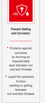

Loctite is designed to lubricate the threads until it sets up. Second sentence below from a screen shot from Henkels website
It also prevents corrosion as it seals the threads and doesn't let air/water into the threads therefore eliminating corrosion. Once you heat it to 400 degrees it lets go and becomes a powdered lubricant for disassembly
Great. Thanks!

Loctite 242 breaks loose easily without the application of heat, but seems to hold well in the absence of extreme vibration. I use it frequently on CRES fasteners. Although I've never conducted any testing that would withstand scientific scrutiny, my experience had led me to conclude that it reduces the well-known galling tendency of CRES threads.

Yes, Loctite will help prevent galling and corrosion. The primary function is locking the threads, yes, but the coating also has important secondary benefits. It also helps sealing.
It doesn't sound like this application would be subject to severe vibration or anything, so you'd be fine with regular old blue stuff. I prefer the chapstick tubes because they're a lot less messy.
