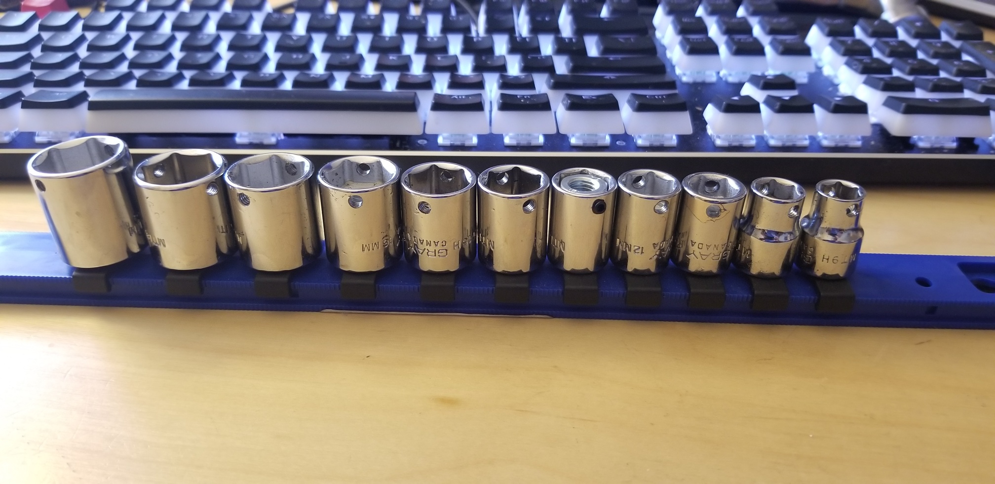

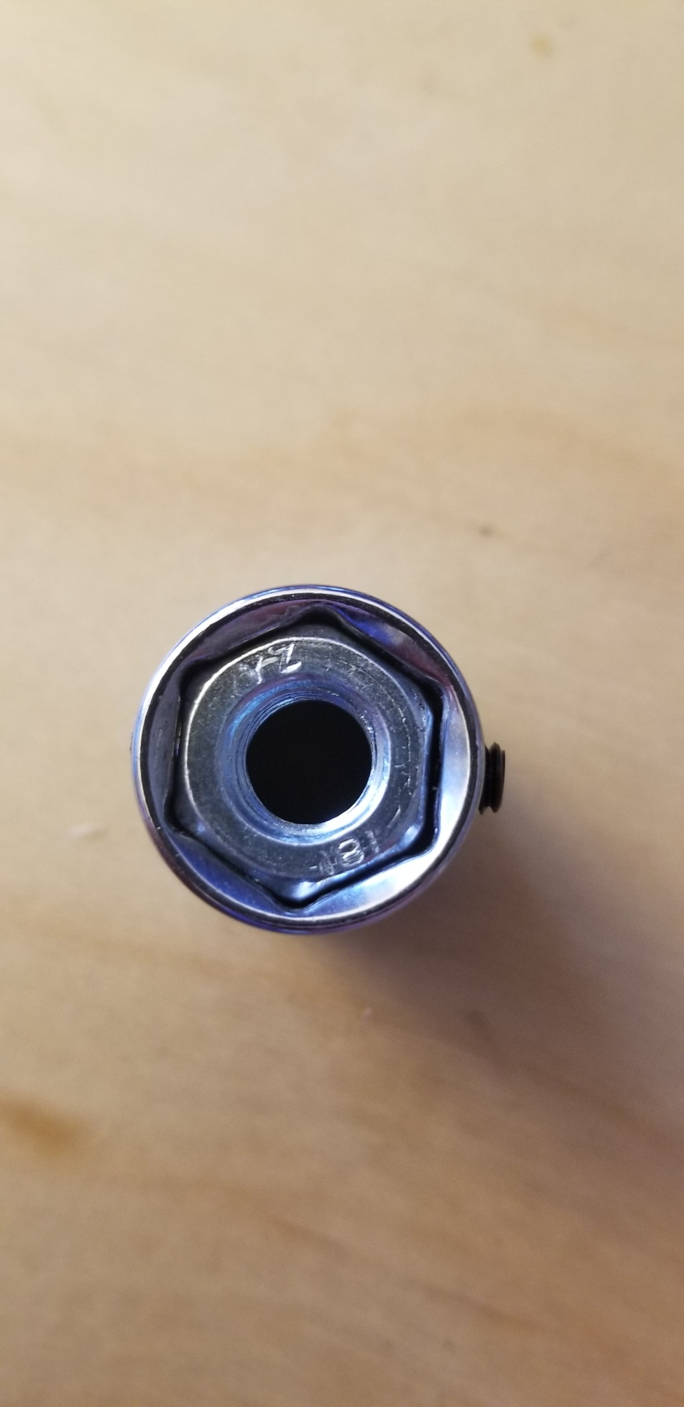

I had the idea of taking a set of sockets and drilling/tapping holes into the flats as a way of achieving three things:
1. A Nut and Bolt retention system where a dropped nut or bolt is a major problem
2. Being able to lock down a socket onto a bolt or nut during removal where the socket will not fall off the nut or bolt when the ratchet is at an angle (think wobble extensions/u-joints/extreme angles/etc).
3. Being able to remove stripped or damaged nuts and bolts
Well, I think I've figured it out. I have the provisional patent and functionally have had a set created.
Drilling something as hard as a socket without it cracking and then being able to tap it without the tap breaking has been quite a challenge without it becoming prohibitively expensive; but we've done it!
Full 3/8 set:

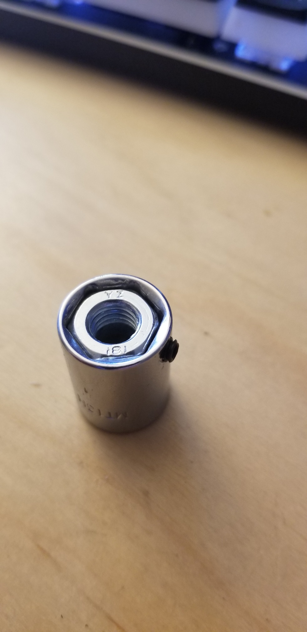

4mm set screw, a 3mm set screw would be nearly flush.

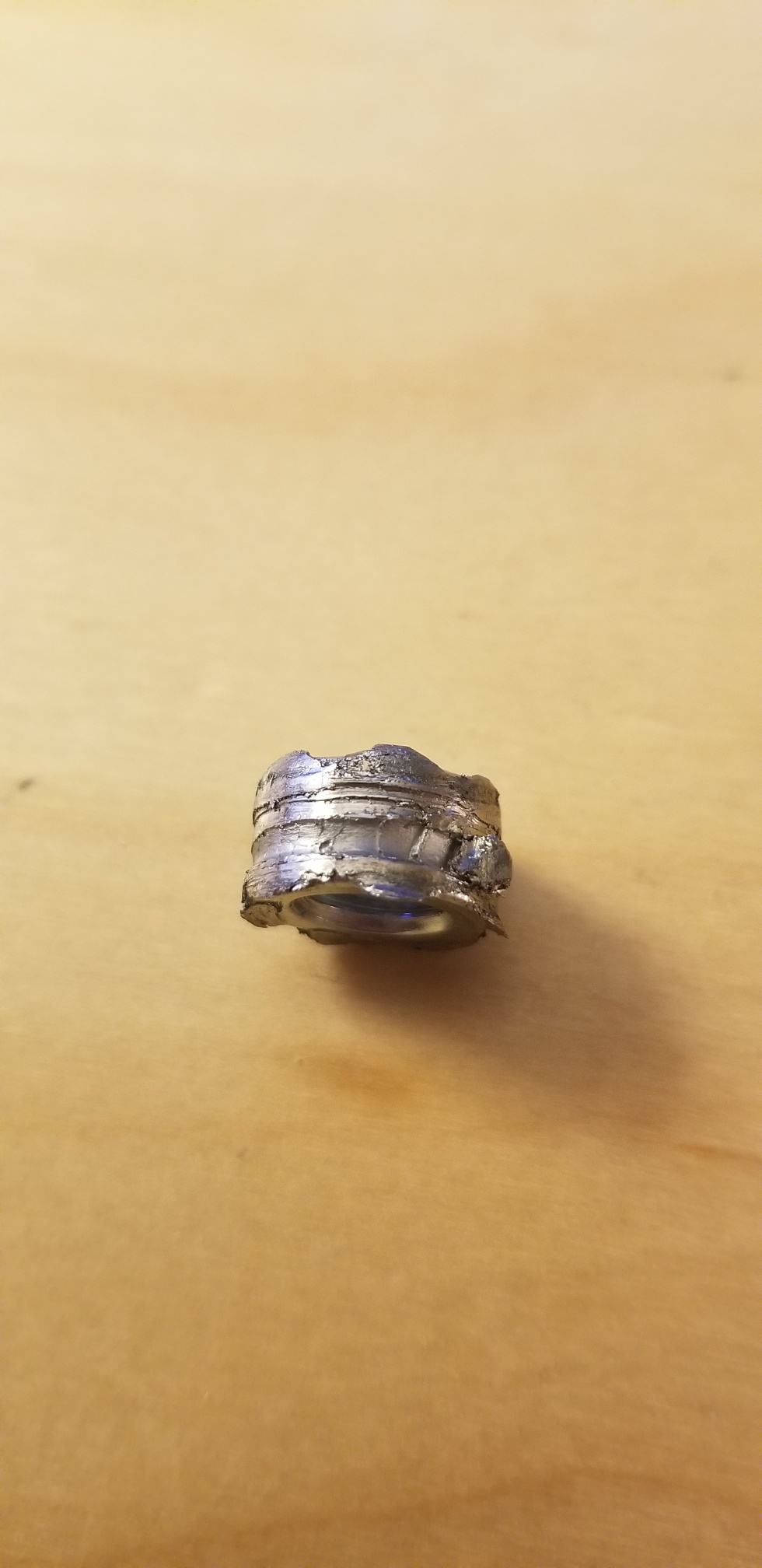

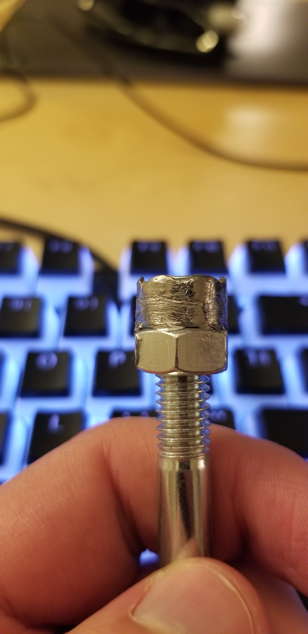

Completely rounded nut as a test subject for removing stripped nuts and bolts:
Post removal:

Devil's advocate questions
- at what torque do they explode from the hoop stress being too high and a hole(s) in the wall
- wouldn't an impact socket be easier to tap? They machine & weld beautifully, something like 4340
- what happens to the setscrew or socket head screw when the little end is all grenaded from carving a divot in the side of a spinning hex and now its time to back it out thru the threaded wall, does it chew up the internal threads

Great questions.
The hardness delta of the bolt/nut and the socket is high enough where there isn't any meaningful difference because of the small holes. From my testing thus far, the bolt/nut fails first, then the 12.9 screw.
It would be easier to tap, however they would also mush their threads at first use. There are only 3-4 threads to work with because of the thickness of the sidewall; you really want as strong of a material as possible.

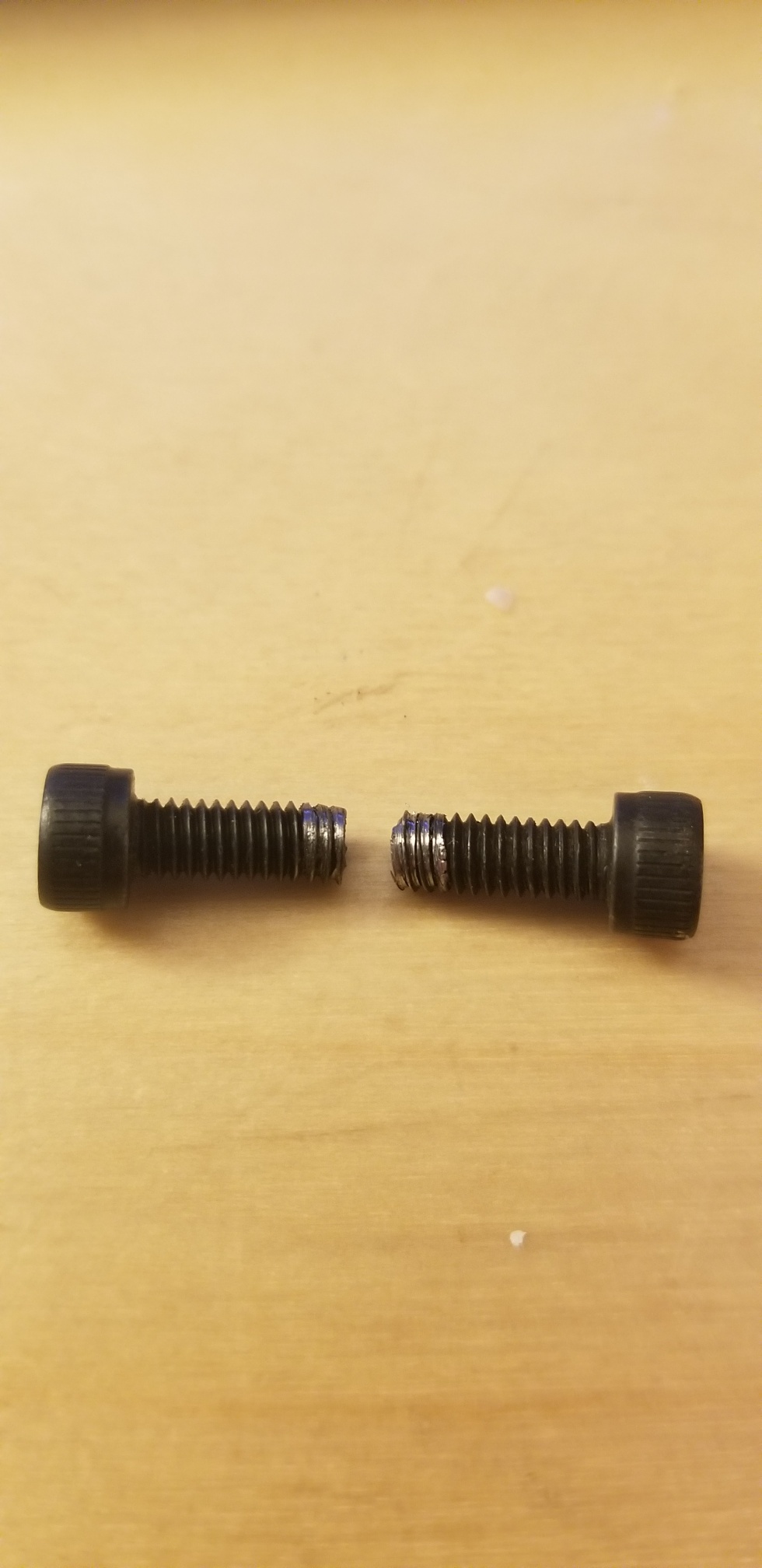

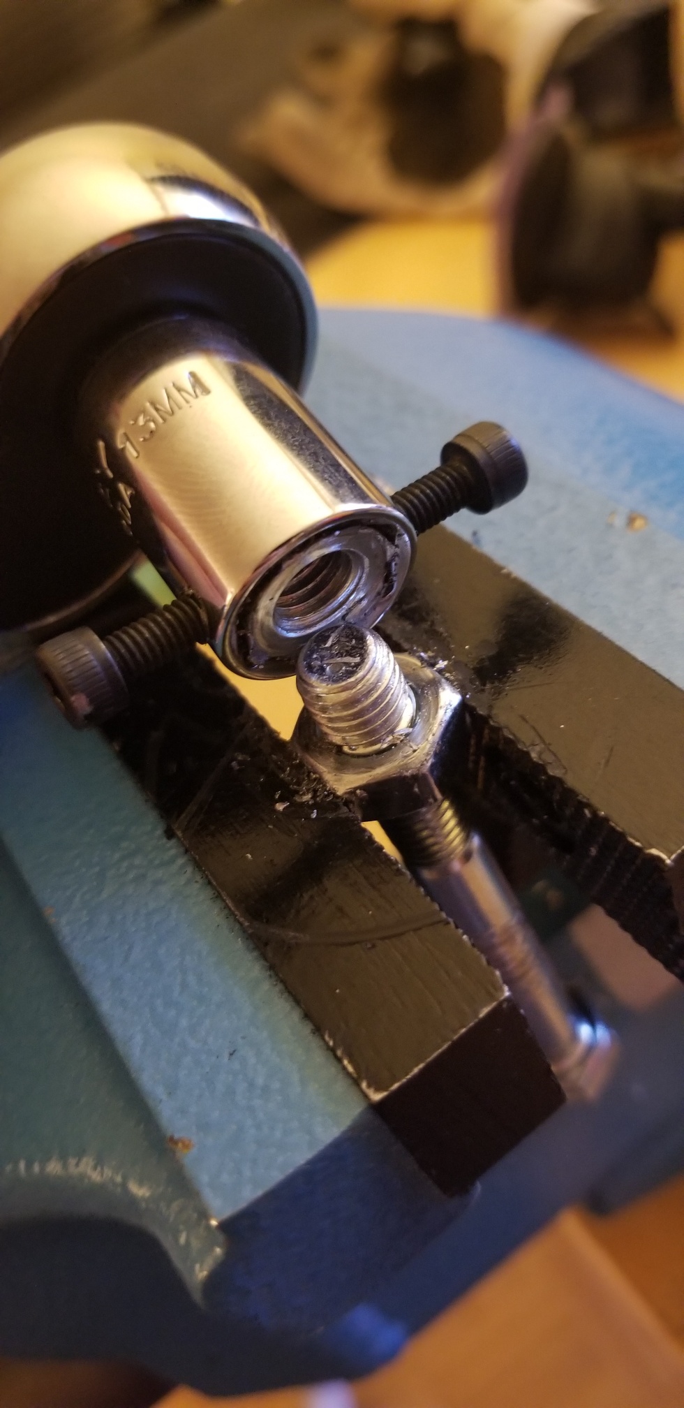

It doesn't; the threads on the 12.9 set screw fail well before being able to deform the internal socket threads. Picture below showing two cap screws that were taken to failure.

Run the set screw forward in to the socket until it falls out on the inside, so you’re using only good threads.

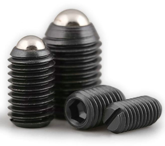

Ball detent on the socket wall... patent pending
Wera & Koken already sell those :wtf:
+1
However, they have spring plunger set screws, so you get the best of all worlds.
The plunger set screws come with all kids of tips (steel, plastic, bronze, etc) and can be purchased in any number of spring strenghts.
