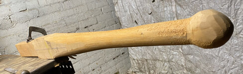

I decided to attach the handle to the head using a mortise and tenon. I drew plumb lines on each end and snapped a line across the top and bottom between the plumb lines. Using a 12” 3/8” drill and building a cradle on the DP table to hold the log plumb I bored through just catching the center point on the bottom (1/4” out only). Using a 1 1/2” drill from the top I went as far in as I could then rolled the log to drill from the bottom. It was easy to get back on center and finally the 2 holes met. A long blade on a recip saw cut relief cuts to the edges of the 1 3/4” x 3” mortise which were then chiseled out.
Using a piece of drill rod and a large C clamp I fashioned a steady rest along side the log and cut the grooves for the ferrules.
I used a stave, quartered and split from another section of the yew log. You can just see one in the top left corner here. Plumb lines were drawn on the ends and snap lines marked to those points across the length. It was then just chain sawed to the board you see in the foreground with the tenon started.
I used my 4X6 metal band saw to rough the rest of the handle shape in.

Then a rasp.
Next came the grizzly realization that I’d measured the handle length off a sledge hammer not realizing that head was only 4” thick. This one is over 9” which eats 5” of the length up. The mallet looked very odd because looking at the 25 lb head you just knew it wasn’t just a one handed mallet, you’d need 2 hands to swing this baby. Time to step away and work on the ferrules.

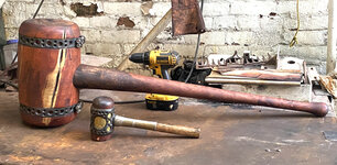

Here it is with my small hand mallet, almost ready to shake things up!

Updating this thread to include my new 15LB mallet. It was made just so I could use the 1st handle I'd made for the 25LB mallet but discovered it was too short when I put it on. (I'd copied the length off a regular sledge hammer not taking into account that the 9" diameter mallet head would swallow up 5 more inches of the handle than my sledge hammer.
In this photo you can see how much tenon is not needed below the head. I'm glueing pieces of yew wood in there to "fill in" the wood that was cut out for the original 9" long tenon.
Here's the handle with the tenon built back up.
Knowing this fudged repair wouldn't be as strong as if I'd never cut the tenon that long I decided to add some thin 10" oak wedges over top of this repair.
This results in a handle that flares out below the head which I was getting ideas on how a tight fitting tapered metal sleeve that attaches to the head would be an awesome method of attaching the head so it wouldn't come loose. (what can happen when you design as you build rather than design then build:).
I made a metal sleeve from 1/8" plate and then welded 1/8" strips along the top, bottom and 4 corners. Then it was heated and peened all over to give it an old appearance. You can see it in the final photos. This turned out to be kind of a bad idea as it had to be heated red hot and banged on to get it to fit right to the top.
The 2"x3" mortise was cut straight through then the top hald was tapered 1/8" on all sides creating a 1/4" flare N-S & E-W. This alone would hold the head on securely but I found the head could still move off the curved shoulder of the handle you can see in the above photo about 1/16". This didn't sit well with me and so why I did the whole metal sleeve thing. I'd need to strap it down which brings us to the next shot.
I didn't like the long tubular look of the head next to the 25LB mallet so ended up going fancy with this maple leaf strap set up which fills up a lot of the vacant area of the long tubular looking head. I tried to impart autumn colours to these leaves by melting brass and copper on the surface but that failed. Then I damn near inlaid the veins of the leaves with copper wire but brighter heads prevailed and I decided to just get the job done and call it good enough. The one thing I still might do is stamp "NOT MADE IN CHINA" on the base of the leaves because I'd rather spend weeks doing something like this than buy some cheap mass produced alternative.
The ferrule rings were made similar to the 25lb head. I shaped 3/4" bar into a diamond shape so they would meet squarely on the surface of the round rings. They were then tapped and torqued into their grooves on the head.
