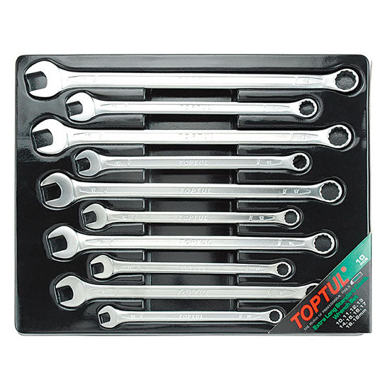

Toptul has had a lot of favourable reviews here:
They also have an extra-long pattern. Not sure if they make it in inches:
Personally if I wanted to add to my wrench collection I’d also consider a set of Stahlwille double box ends. You shouldn’t need more length on the open ends than your existing set, and I believe double box are fairly long pattern.

For LONG combination wrenches the TOPTUL are the answer and as mentioned above are available in SAE, they simply are not available as an SAE set as they are in metric. If things really get bad Muller-Kueps and others make wrench extenders that can be used with these to get really long.

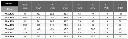

Toptul extra long in SAE is different design to the metric (typical taiwan issue on how they outsource and use what already got tooling)
They still proper long though but only do 7 sizes and hardly anyone stocks them .
Is another useful thread on long combo wrenches (metric) with some length measures that may help make decisions on what work for you ...
Some long wrenches I really find useful daily is the ICON long combo ratchet wrenches by high-five, nice XL length (pretty much same as toptul extra long) and very useful ...

I agree with the Icon recommendation. TOPTUL is interesting in that for their SAE stuff they typically go full polished rather than Satin Chrome as is the case with these extra long combination wrenches. When I was selling them somebody who's on this board (I don't remember exactly who - It might have been Jim in Virginia) had me bring in individual boxes of the SAE TOPTUL. I suppose he made up his own sets from them.
yeah but it not just finish polished, the wrench forging design totally differs too, it more a snapon style beam and ends rather than than recessed and slender german style of the metric set, seems to me they just use whatever tooling the foundry already has available rather than up production costs of specific design, same reason they got lot of size skips/limited range ... they kind of too stingy sourcing manufacture and backing the products to actually make what would be easy brand gains up the professional class tool podium .
