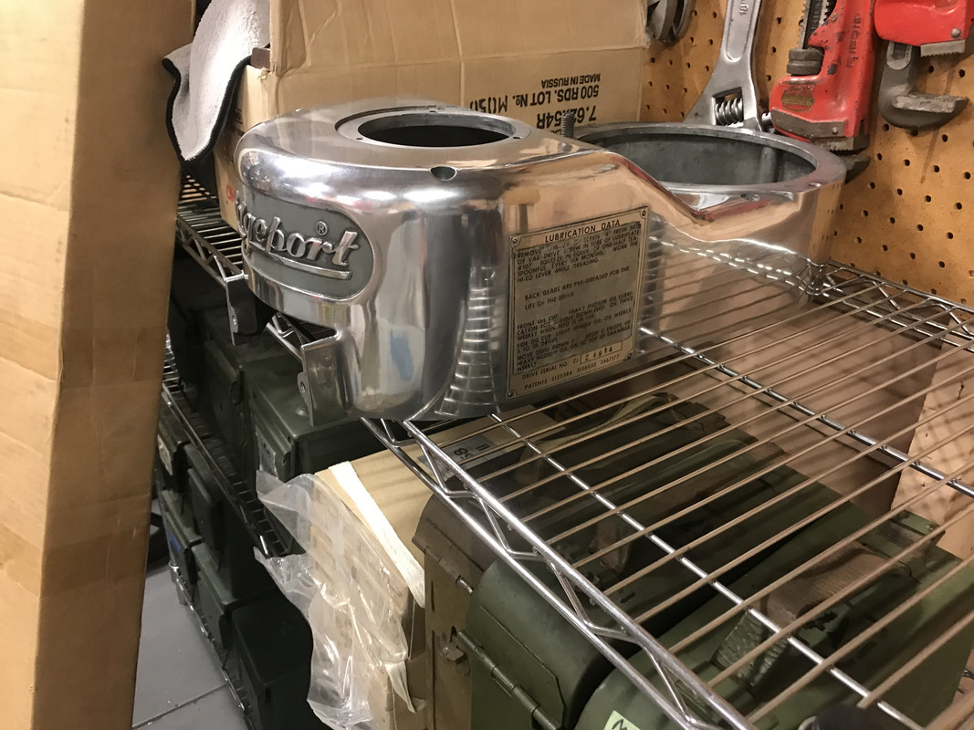

Looks great! I polished my BP head when I rebuilt it. It will not stay shiny..dirty hands up there with the draw bar, drum switch, in your case changing belts. I give mine a quick polish every now and again but it dulls quickly. I would also like to hear other opinions on this.
Then again I may be too picky. See for yourself, I just snapped this pic of the head uncleaned as it sits in this moment.
This is before and after about a year with a quick mother’s wipe every 4 months or so.

Nice work. When we rebuilt them, we just wiped them clean as they were sent out to production use = back when we had factories in CT.
