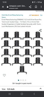

Thank you for the replies. When I opened my toolbox this morning I think the solution to my problem was right in front of me, I just never noticed it before.. if I stick one of these through the back of a ratcheting 17 mm and into the Nano socket it will retain it and the plastic won't mar up anything on the socket and being quarter turn it should be locking also.

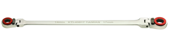

Bought the KTI-43517 finally after looking at it for a while and needing it about a month or two ago for an alternator replacement.
It holds up to 18mm vertically without any issues, the 19mm needs to be held at an angle for it to hold without any modifications.
Should still be useful without modifications. Certainly worth the money at only $17 shipped on ebay.
