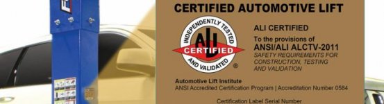

heffneil.. I'd suggest you only by a lift that has ALI certification. Here is a link to the list of which one's are.... Directory of Certified Lifts
Not all Rotary Lifts are made in the USA. Call them and ask about the specific model you are wanting............. Contact Rotary Customer Service
Looks like the bendpak I was interested in is certified? I read somewhere people said that if it doesn't have the sticker on it, it isn't certified.
lakeroadster
Jan 19, 2015
5,166
Central Colorado
Automotive Lift Certification..... Look for the Gold Label
  • ALI-Certified-Automotive-Lift-2015Gold-Label-on-lift-cropped-view-1024x278.jpg
