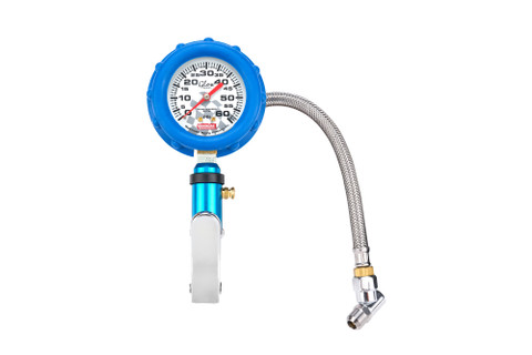

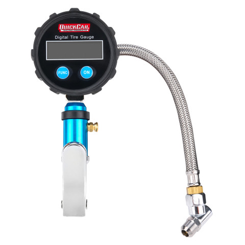

Good evening everyone
Today my JACO chucks came and I'm sad because I now realize that I cannot simply use one on my Viair inflator to try it out; it appears that the hose is a 1/8" (?) MPT at the inflator not 1/4" and the chuck, which is failing, is crimped onto the hose and does not unscrew. Before you jump on me and say "why didn't you look, O *** of limited intelligence" in my defense I am never home when it's light out this time of year, so I was examining the thing by dim streetlight while trying to inflate my tires. Anyway, apparently I really do need to order an inflator, it's not just a want anymore. I should have another Viair inflator laying around (thrift store scores FTW!) but I'm assuming that if the chuck on that works, it's on borrowed time since the one in the Jeep already is failing.
Contenders so far:
Longacre (maybe? I'll explain) Longacre 60 PSI digital is spec'd at +/-0.2 PSI or 0.3% is that legit? My inner engineer likes that if that's valid. Analog 60 PSI is +/-1 PSI or 2%. However, I read somewhere while researching that someone said they couldn't put the JACO chuck on a Longacre inflator so if that's true, that's a negative, and means I was mistaken above when I said that all the ports were 1/4" NPT. Now I'm going to have to examine my tire pressure gauge and see if that is the same.
JACO - seems legit. I know the JACO chuck fits because it comes with one. Also cheaper than Longacre, either analog or digital is under $40. JACO 100 PSI analog is rated +/-2%, the 200 PSI digital is rated +/-1% so either one should be +/- 1 PSI.
QuickCar - don't know anything about these. Seem comparable to Longacre. Couldn't find gauge spec.
Branick - recommended above. Doesn't use replaceable gauge but apparently can take an aftermarket chuck. Analog is +/- 2 PSI and reads to 174 PSI. Digital is +/- 2 PSI and reads to 250 PSI.
So what would you fine folks recommend? I'm tempted to order the JACO analog, what would push me over the edge is if someone could tell me that all the ports are 1/4" FPT (I guess they all have to be except for maybe the hose connection at the inflator, yes? And why would the hose not use the same connection at both ends?) Then if I decide that it's not accurate enough for my engineery self I could just replace the gauge head with a Longacre digital head or something like that.
Thanks for any advice.

All liquid-filled gauges I've seen or used had glycerine for the fill.
IMHO, a liquid-filled gauge is useless for 99% of what we use gauges for. If it's mounted directly to a piston compressor or other high-vibration situation, sure, but not for a tire pressure gauge or much anything else.
Liquid-filled gauges WILL leak with large swings in temperature or pressure--like you'd encounter in a car. There's a rubber plug on the gauge you can remove to drain it.
