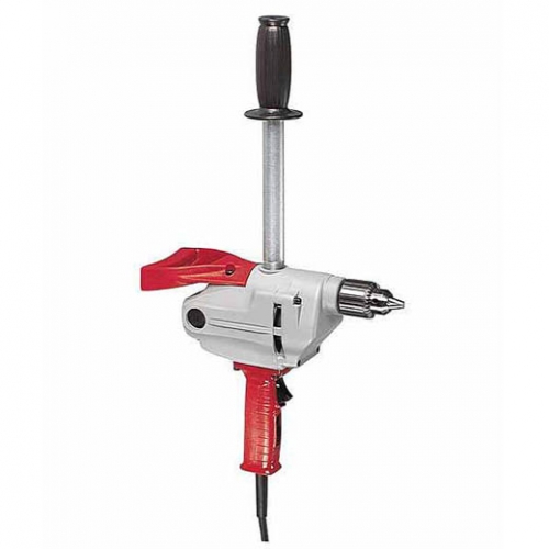

Makita ds4000 or milwaukee hole hawg? The Makita draws 9amps vsthe hole hawgs 7.5
https://www.milwaukeetool.com/Products/Power-Tools/Drilling/Right-Angle-Drills/1675-6#sp-specs
https://www.makitatools.com/products/details/DS4000
I have been in construction for 26 years and don't recall ever seeing a Makita corded drill on a jobsite whether resi or commercial. I have a Miilwaukee hole shooter that looks similar to the Makita and wouldn't attempt to run a bit through three 6X's. Milwaukee makes two Hole Hawgs. A 900 rpm single speed and a 300/1200 two speed. I have the two speed and wouldn't hesitate to drill the holes, but it's gonna take low gear and a really sharp bit to get all the way through. I have doubts about the 900 rpm drill getting the task accomplished. Also, low gear will throw a lot less concrete around when mixing.

That Hole Hawg comes in a straight configuration too. The RPM is 650.
That's the Hole Shooter. I have one but I believe it's 900 rpm. I wouldn't dream of using it to drill a hole through three treated 6X's. The 650 rpm version will definitely have more power, but I doubt it's enough.

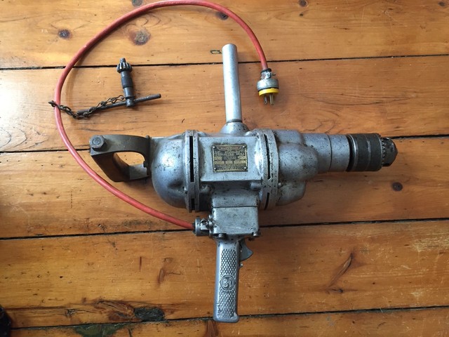

ClappedOutBport
Mar 30, 2016
998
It's interesting to see the B&D recommendations.... I haven't had much success with their stuff, but I don't own the old stuff, only from the last few years.
edit: I'd suggest Milwaukee or Dewalt
I guess you never heard about when they started shoving their good tools off to DeWalt and other brands and cheaped B&D out to hell and forever ruined their image.
Old B&D stuff was the best you could buy. Dad has a grinder from the 40s, it's still used all the time.
Oh and FWIW, the 1/2" and 5/8" drills everyone is recommending here (and I concur) where actually on the lower end of B&D's line up. I have the #361 drill on page 5 here. It runs at 400 RPM and is 4.5 amps and it will hurt you. And yet, it was only a standard duty drill, nothing compared to the big boys they sold. They had damn Timken tapered roller bearings in the bigger drills! They were, and are, amazingly good at what they do. The 1 1/4" looks like a 3 man operation. Two to take the torque and steady it, and one guy leaning all his weight on it.
http://vintagemachinery.org/pubs/101/20564.pdf
