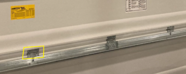

here are a few stills

That first picture looks like the hinge is twisted and it appears to have a wear mark forming. That should not be happening.
excellent, thanks for pointing that out. I can see it is twisted but what does a wear mark look like? The black stuff appears to be grease.
The black mark looks like a wear mark since it is in such a small area. Maybe not.
Now that I look at it, it looks like most of the hinges are twisted.
I would definitely contact the installer. There is a lot going on on that door, and with living in what I am assuming is south florida, you want it to be right.

yeah, that one hinge is definitely not lined up horizontally and it looks like a couple other might not be either. I would go thru ALL HINGES and TRACK WHEEL mounts to make sure everything is lined up the way it should be.
I don't think the door lift installer knows anything about garage doors, he just installs lifts because, how hard can it be? brand new houses are infamous for fast build/no quality checks. even my upscale home built in the early 80's had some things done wrong I have been fixing for the last few years (mortar for a chimney crown when it should have been concrete, punched mesh stapled to the wall for holding thinset in bathroom showers and tub areas, etc)

the hinges appear cocked, and binding. They should not bind like they are. Eventually fatigue cracks will follow. Right now I would call him and show him the binding manually so he can see the problem in slow motion. Then depending what he does next will tell you what you need to do next. The door should operate smoothly without binding.

Wayne dalton - probably a 9100. The hinges are pre-installed from the factory - and often are very much like that. But they've got generally enough movement to allow 10deg or so misalignment.
What's the outside face look like? is there any creasing near the rabbets (where the 2 sections meet)?
Just to expand on that - the popping in my experience - was often due to some rough handling on the rabbets, banged while loaded/unloaded off the truck - or strap damage when being hauled to site.
this series of door - you could get a little bend on the rabbet (very top triangle) and you'd get that pop. Usually just some minor massaging by an installer can get it running smooth again.

seconding jstroede, those smaller hinge place look cockeyed. Likely bolts buzzed on with a powered driver, ceneter bolt first, which would have spun the plates clockwise up against the 2nd and 3rd flanking bolts. Which means grease or no, the hinges aren't moving as freely as they should. I'd loosen them all, run the door up and down by hand a few times and align the hinge plates vertically and snug the bolts back down by hand with a ratchet, watching for that rotation.
I would also take a close look for alignment at the joints of the tracks, especially where the radius sections meet the vertical and horizontal rail sections. A bad misalignment there could give you that popping noise or hesitation in movement.
I don't expect the door will ever be quiet or near-silent. But the popping noises definitely mean something isn't right.
