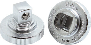

Does anyone know where to get a square drive adapter like this one from stahlwille but with a ball detent to hold the socket instead of magnets? I realize this one is supposed to adapt a 1/4" to 3/8" drive so it has the hole for the ball on the 1/4" square drive to set in but I don't think it has a ball for a 3/8 socket to snap on to.
There's these from OEM but they look unnecessarily thick:
The idea would be to use the Astro nano sockets with a standard ratcheting wrench and use one of these to retain the socket.

F-22
Jan 23, 2022
1,830
Koken makes nice ones.
Nepros too...
And KTC also adds a simple angle meter so it can be used a bit more accurately for those torque angle settings.
DIYNY
Jun 25, 2022
31
Nepros too...
none of these will work for the purpose he wants, they are not flat where 3/8 drive tang begins.

Sorry, don't quite understand what he needs
Basically he needs something like this but with a detent ball instead of a magnet.
I have been using 17mm wrench with nano sockets for over two years now and I find that I rarely need any socket retention. And it's easier to switch sockets or remove a wrench and spin socket off by hand when there is no retention. When I need socket to stay firmly in the wrench I just put a piece of paper towel between socket and wrench.
