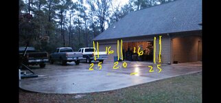

Those doors seem small to me if your trying to store 3 cars and also have a lift.
Example. My garage (4 car) has two 16ft doors , width is around 40ft .
I can comfortably park only only 2 trucks and one 73 vette. The vette is centered between the doors and takes a little maneuvering to get it in and out.

28x45.
4 or 5ft on the right where the hose is a stairwell , closet space and sink on that wall.
So usable garage space around 26x40.
I park my F150 with 6.5 bed in there with a fridge in front of it. Still plenty of room depth wise.
A suburban on the left side with my workbench in front of that. That left side area is actually 28ft deep due to a gable bump out on the front.
For me a 16ft door is only good for one big vehicle. For small cars you could get two cars but would be a little tight.
If your having a lift will you still be able to park a vehicle in that space under it or will it just take up space until needed?

And the next paragraph..
28x45.
Roughly..
